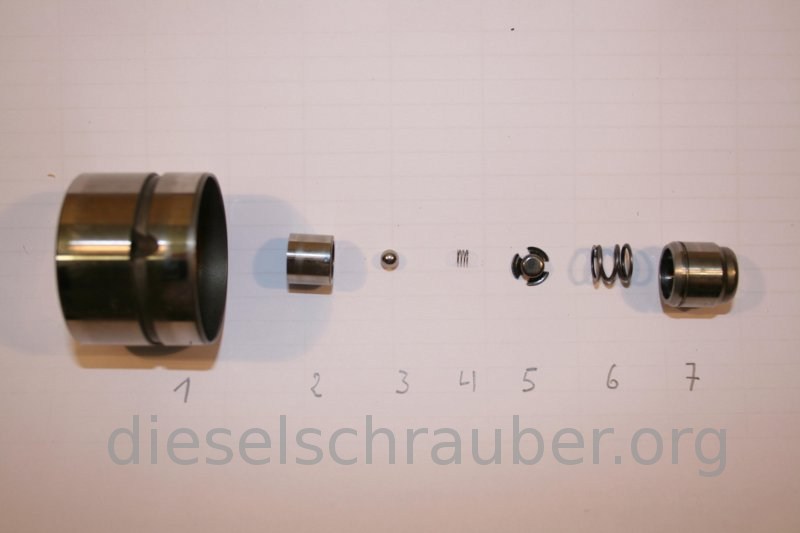

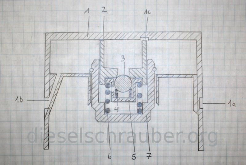

Image 1 shows a cross-sectional view, and Image 2 shows the individual components of the disassembled hydraulic piston.
Function:
Inside the engine, the hydraulic piston is filled with pressurized engine oil through the ring groove 1a and the oil channel 1b. The oil is then further pushed into the piston 2 and into the space between the piston and the piston cylinder through the reservoir 1d and the oil channel 1c. The plunger core is additionally pushed apart from the spring force, so that the plunger housing and plunger core are pushed against the NW (Northwest) or the valve.
The oil pressure is not sufficient to force the valve against the force of the valve spring. The check valve closes when the oil pressure in the piston cylinder is equal to or higher than the pressure in the reservoir. This makes the piston core rigid. The rising lever of the NW can open the valve.
Through the gap between the piston and the cylinder, as well as between the cylinder and the cylinder housing, leakage oil flows into the ZK.
As the cam lobe wears, the tappet is relieved of pressure. Oil leaks are compensated for by the oil being pushed back into place. The spring and the oil, which is compressed by the check valve, ensure that the piston housing and piston remain in the fully extended position.
Differential thermal expansion is maintained through the interplay between oil leakage and filling due to oil pressure.

 Bild 1: Schnittbild des Hydrostößels
1 – Stößelgehäuse mit Ringnut (1a), Ölkanal (1b), (1c), Vorratskammer (1d);
2 – Kolben;
3 – Ventilkugel;
4 – Ventilfeder;
5 – Federkappe;
6 – Stößelfeder;
7 – Stößelzylinder mit Sicherungsring (7a);
 File size:  84.47 KB
 Viewed:  24924 times
 Bild 2: Einzelteile des Hydrostößels (Kennzeichnung der Teile wie in Bild 1)
Die Teile 2 – 7 bilden zusammengesetzt den hydraulisch variablen Stößelkern, welcher durch den Sicherungsring 7a im Stößelgehäuse gehalten wird.
Die Stößelfeder 6 drückt den Kolben 2 und den Stößelzylinder 7 auseinander, im komplett integrierten ZK auf Anschlag gegen die NW und den Ventilschaft, ansonsten bis zur Anlage des Sicherungsrings 7a am Stößelgehäuse 1.
Die Teile 2-5 bilden ein Rückschlagventil.
