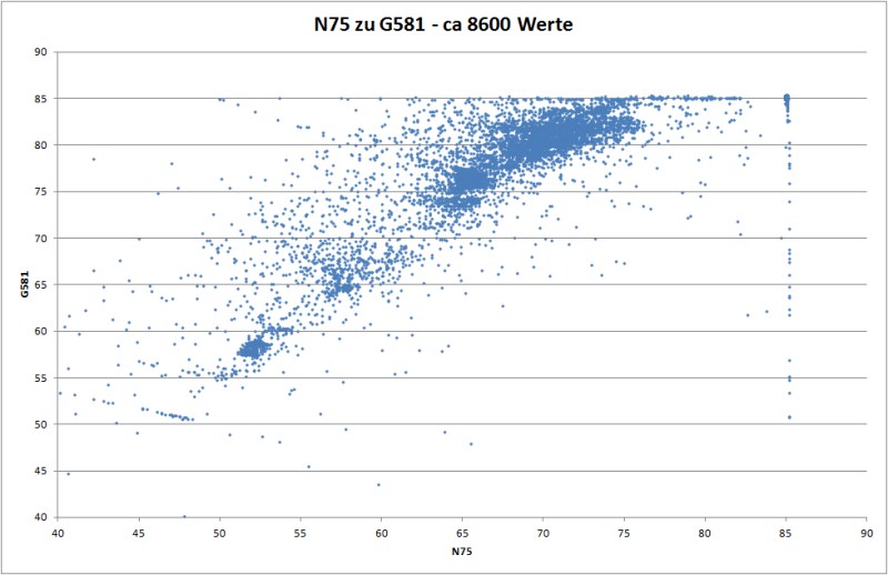

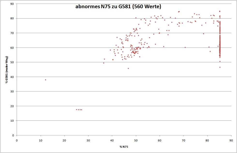

Post08-02-2013, 11:28    Subject: Passat 2009 power loss Quote
CRs and the BMR are perfectly suited to identify this error.
N75 and G581 in a scatter plot - done.
The sensor G581 is the position indicator in the vacuum chamber. You can clearly see if, for example, the membrane is torn.
Normally, there is a roughly linear relationship between N75 and G581.
If the values are too close to the edges, something is not right.
You can also attach a syringe to the container and observe the readings from the G581.
 File size:  52.2 KB
 Viewed:  3753 times
 File size:  60.15 KB
 Viewed:  4765 times
Translated on 07-07-2026, 8:32.
