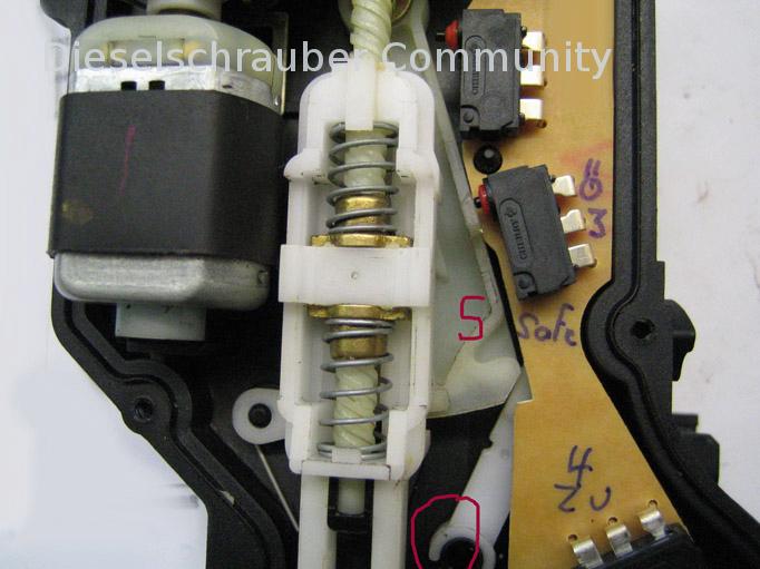

Post07-02-2013, 15:04    Subject: Passat 3BG 2005 Door Opening Quote
Here's a possible translation:
"The suspected issue is a broken redirection lever inside the lock. The safety lever (S) is located on the right side." Therefore, the mechanism is blocked (provided that the paddle on the locking cylinder is intact).
If all other attempts fail, I would first remove the lock cylinder and the door handle.
If the rear door is open, the mounting screw for the cylinder becomes accessible (if necessary, remove the rear door).
"If the paddle is broken, use a screwdriver to open the lock. Otherwise: If nothing can be done through trickery, I would carefully saw through the locking bar with a bent saw blade. Possibly." Cover the saw blade with tape for protection.
After that, everything as usual: replace the lock, check the cable entries.
PS: If paint damage occurs, which hopefully won't happen, it's usually cheaper than damaging the interior of the door.

Post07-02-2013, 19:05    Subject: Passat 3BG 2005 Door Opening Quote
I wonder if it would be possible to directly manipulate the locking mechanism to open it using an external current applied to the connector of the comfort control unit?
"As far as I know, this would have to be done via the door's control unit (STG), since the STG 46 only provides control signals."
I suspect that initially, the diverter lever (which is only responsible for mechanical opening with a key) was faulty, and no one noticed. The electrical fault occurred later.
As I said, I would start by removing the lock cylinder. That can be done even with the back door open, without using force.
