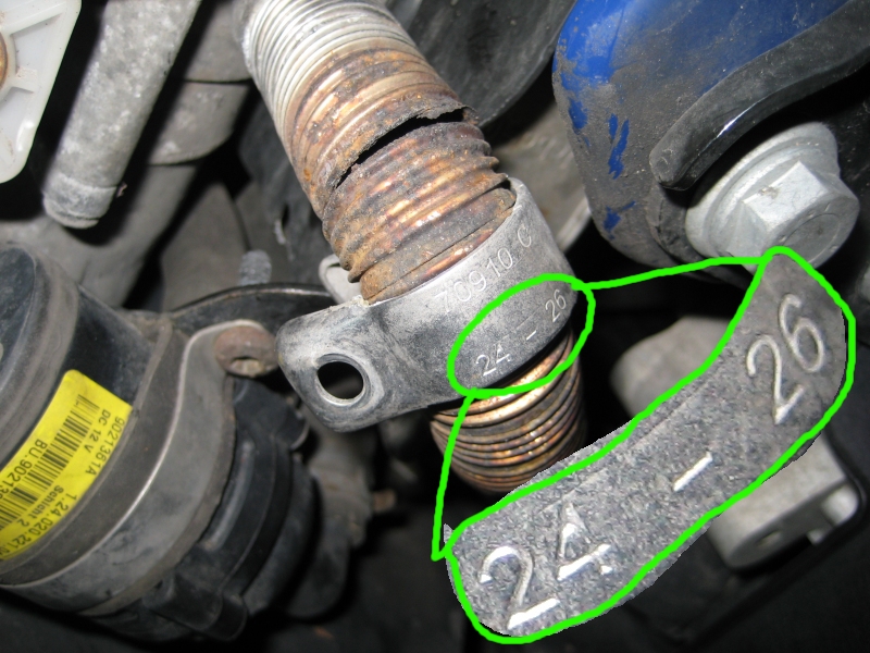

Hi.
I currently have a 2010 Touran with a crack in the exhaust pipe of the auxiliary heater.
While the individual parts are labeled in the picture, they are not sold separately; they are only available as a complete exhaust system.
Does anyone know of alternative sources for 5 cm corrugated pipe?

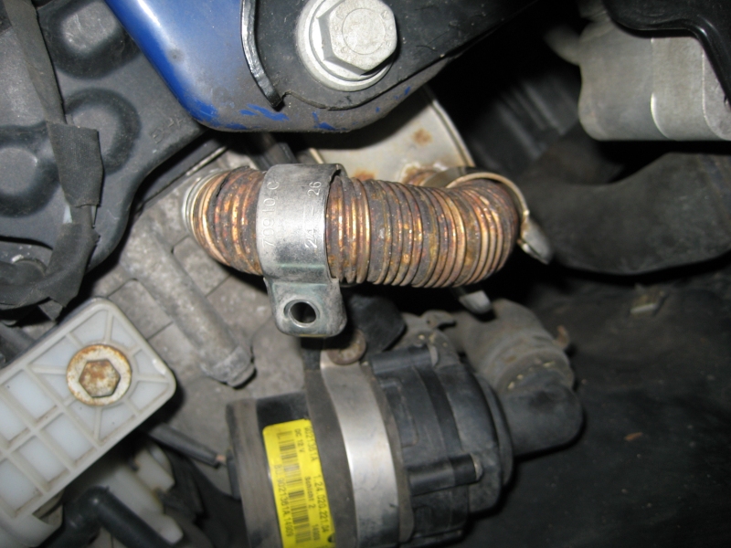

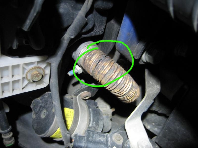

Here comes the big one.
In the Golf (same heater as in the turkey), you can buy this part separately.
1K0 819 178 C
Okay, I'll get back to you later - I need to go take my measurements.
Joined: 03/13/2003
Posts: 10121
Location: in der Werkstatt
Post27-03-2013, 19:36    Subject: Exhaust pipe for auxiliary heater Quote
SHIT
Horn off.
Remove the bells.
and now it's not going any further - the pipe is really stuck on the two flanges.
And if I just wrap GUMGUM around it?

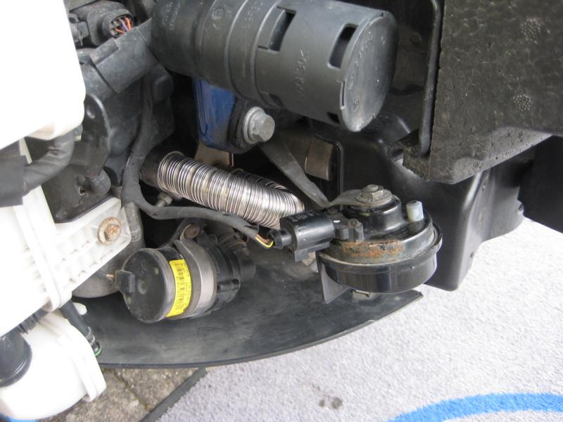

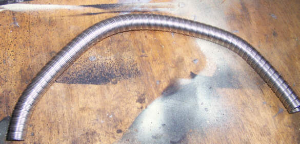

Post30-03-2013, 16:47    Subject: Exhaust pipe for auxiliary heater Quote
The old hose crumbled in the middle.
I have wound down the ends.
With enough courage, everything went perfectly smoothly.
I had to scrub the bottom of the SH very thoroughly.
Unfortunately, I made the new arch slightly too wide (the old one was 20cm when measured, the new one was shortened to 21cm), so the horn had to be repositioned icon_smile.gif.

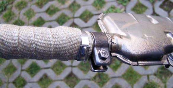

Post31-03-2013, 8:11    Subject: Exhaust pipe for auxiliary heater Quote
Eberspächer and Webasto both offer heat-resistant rubber sleeves that can be slipped over the exhaust pipe to keep it a safe distance from other parts, especially in tight spaces. Heat-resistant tape commonly used in motorsports is also excellent for insulating the exhaust pipes of auxiliary heaters. As a result, the exhaust pipe will be at best hand-warm, and the risk of fire is eliminated.

Post31-03-2013, 10:29    Subject: Exhaust pipe for auxiliary heater Quote
NE,
There's nothing wrong with the pipe.
I only measured it a bit too long, and I only realized after the complete assembly that the horn still needs to go in front.
Okay, I've adjusted the horn mounting bracket, all done.
If you compare my first and last picture, you can guess what I did by looking at the steps of the stand.
Removing the pipe bend again seemed like too much work, and I felt that it rusted through so quickly (MJ10) mainly because of its tight bend.

Post31-03-2013, 10:48    Subject: Exhaust pipe for auxiliary heater Quote
It's okay. I just meant it in a general sense, in case someone ever needs to install exhaust pipes like that. In the engine compartments of modern vehicles, which are often enclosed with plastic, the fire hazard posed by auxiliary heaters is a factor that should not be underestimated.
