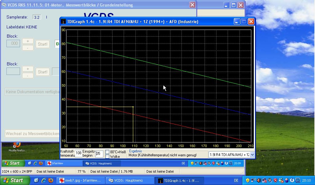

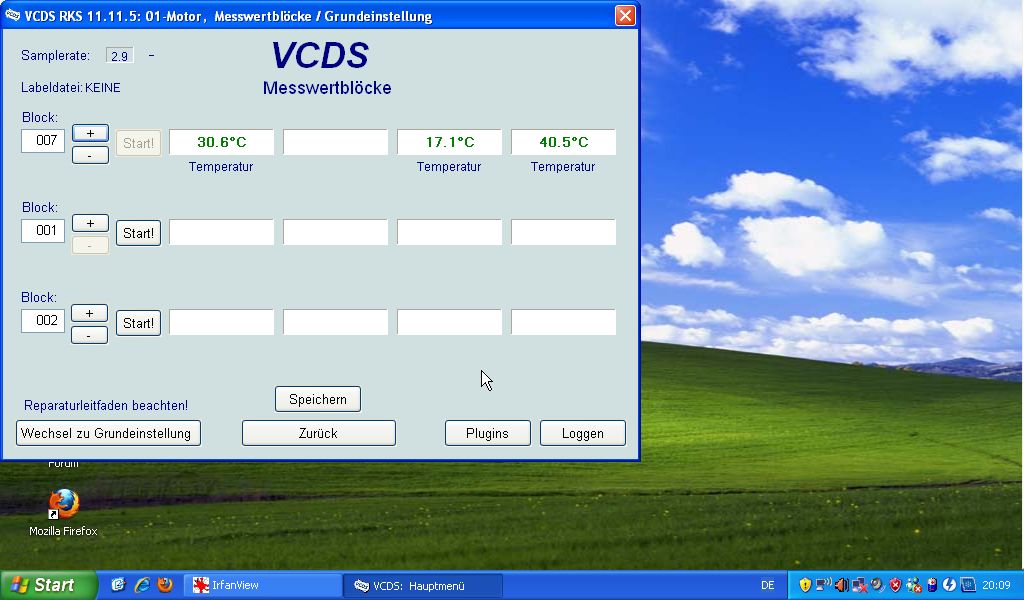

I just took two screenshots, one of MWB7 and one of the TDI timing in the basic settings mode.

You can only roughly check the injection timing on a cold engine. Warm the engine up to at least 85°C and then check the values in MWB 0 in the basic settings mode. Make sure to select the correct engine in the timing checker as well.
The measured values of 35 / 100 look suspiciously like MWB 0.
Edit: Your post with the Screenshot was faster. Please make sure to properly warm up the car first.

In MWB 7, I'm not exactly sure which temperature setting applies to the diesel engine, as I'm missing the corresponding label file.

In the MWB 7, I don't know the exact temperature setting for the diesel engine, as I'm missing the label file for it.
007.0, Temperatures (engine cooled down)
007,1,Fuel,Temperature,Setpoint: Approximately ambient temperature.
007,3,Intake manifold temperature,Target value: approximately ambient temperature.
007,4,Coolant temperature, setpoint: approximately ambient temperature.
Drive the engine as Herbert suggests, and let it warm up first. The temperatures indicated in MWB 7 seem reasonable.
