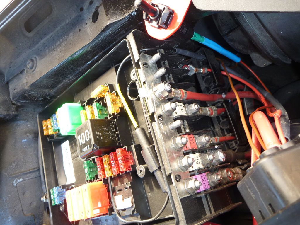

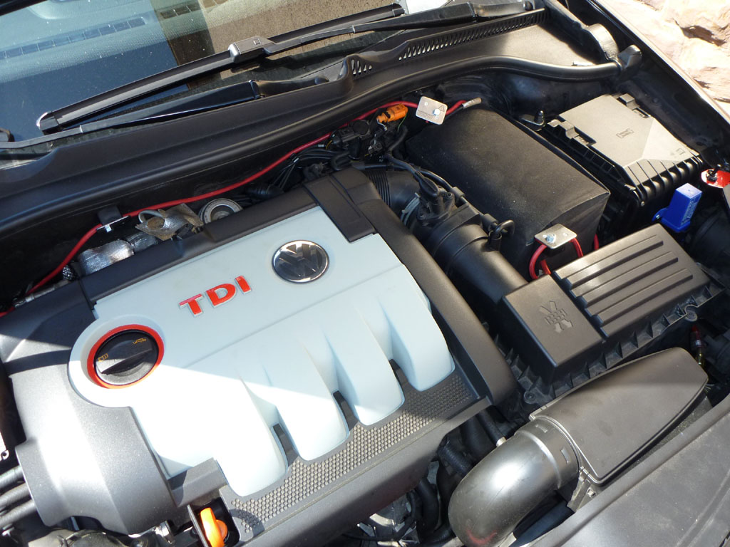

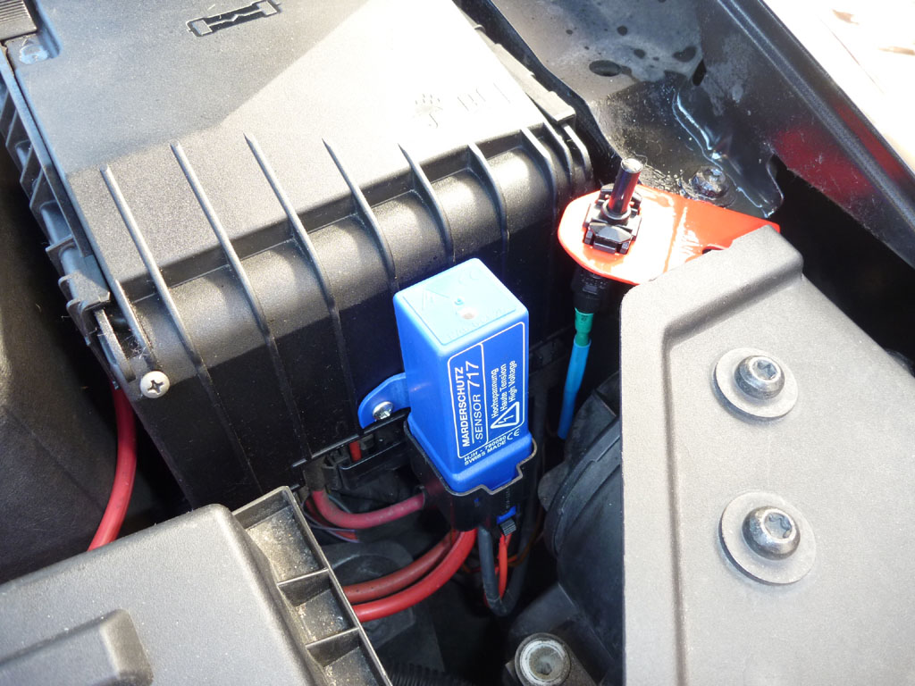

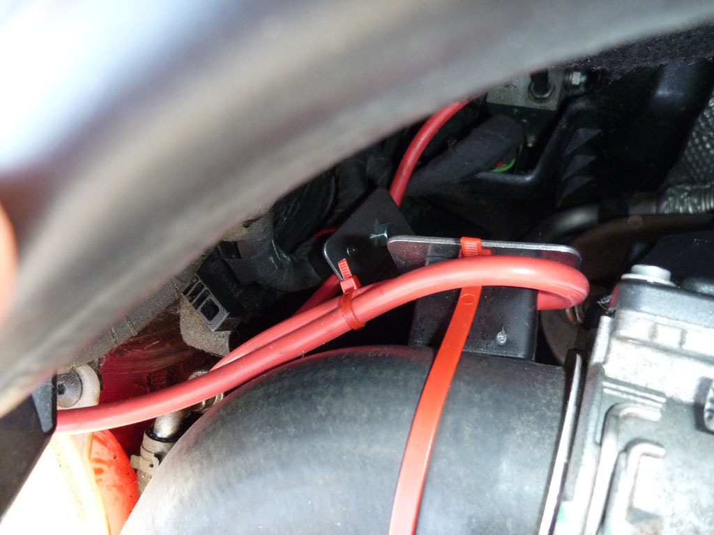

I've now installed a weasel-repellent electric shock system in the engine compartment, after dealing with a multitude of smaller damages (and a lot of debris and dirt) over several years. Well, I'm almost finished. Now I know where the weasel runs, hides, and sleeps.
Be very precise with time. This allowed me to install the contact plates accurately.
The difficulty is locating terminal 15 in the engine compartment.
Inside the main electrical panel, there is only one pin that provides a 15-ampere current – and that is the pin connected to the relay located inside the main electrical panel.

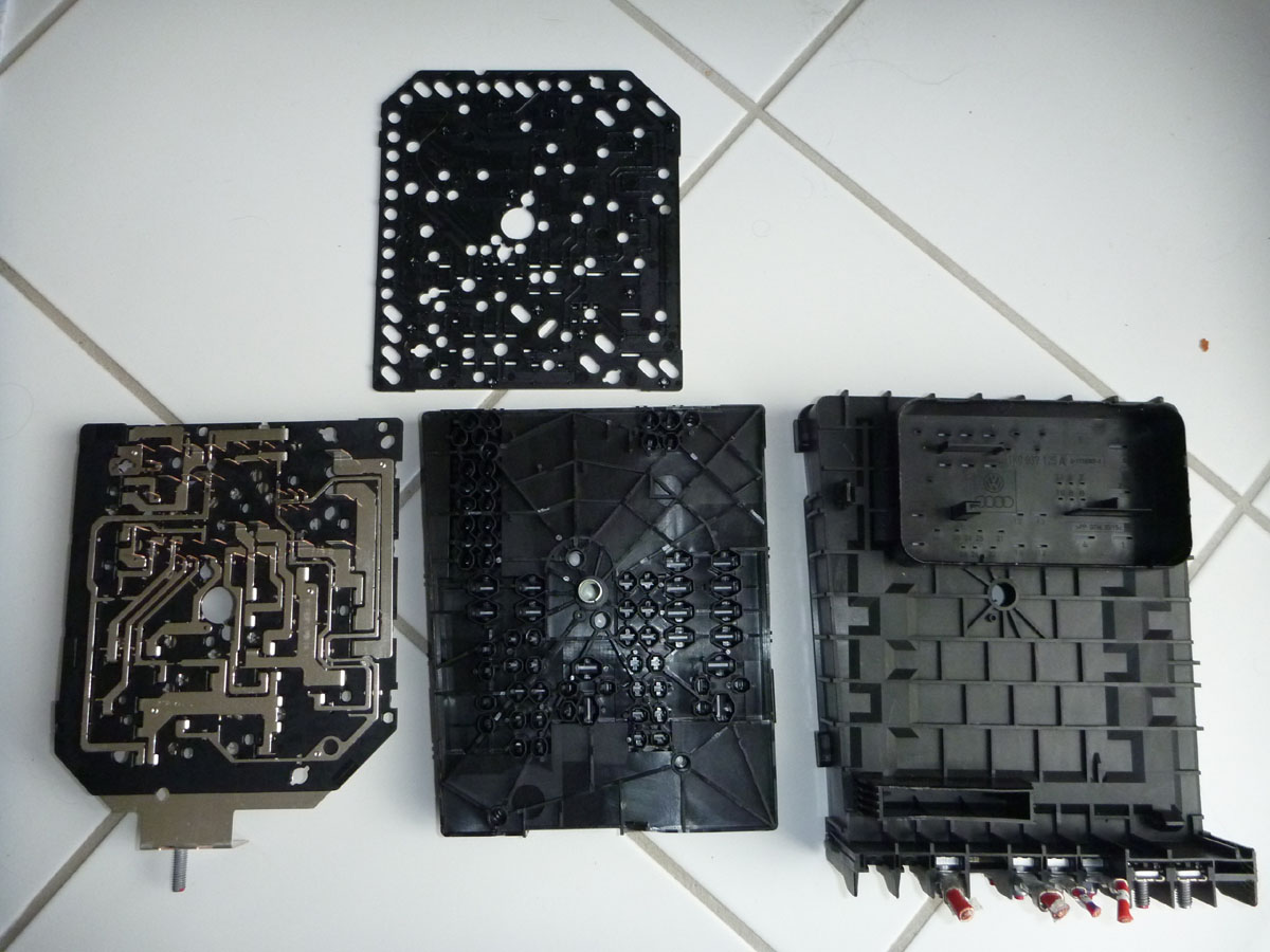

I got a central electrical panel from a scrapyard and took it apart because I wasn't entirely sure about the wiring diagram.
But it's probably really like this - only one pin on the relay is labeled "15", and that "15" connects to the wire that comes from the connector at the bottom.
But - I'm getting power to it, regardless of whether the ignition is on or off.
Why? Am I making a mistake in my thinking?
I've also waited for 15 minutes before - unfortunately, the situation is the same - it's still getting power.

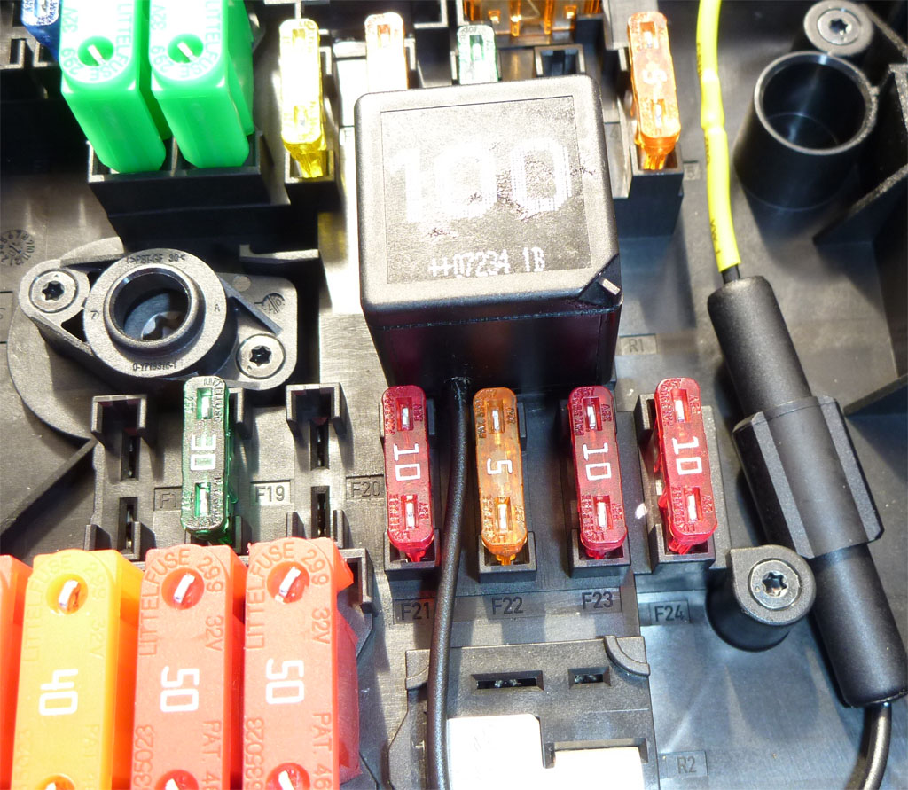

"Regarding image 4: I've always connected things through the relay to reach the pin on my vehicles, for as long as 30 years - however, until now, none of my vehicles have had a CAN-bus system icon_smile.gif."
The badger system is designed to be compatible with vehicles that use a CAN-Bus.
VW Golf V Variant, year of manufacture 11/2007, model 2008.
2.0 TDI Diesel 140HP DPF (BMM) - DSG (KCU)
Marten repeller system version 2.0 SENSOR 717 (CAN-Bus tested).

 Anzapfung des Pin "15" durch das Relais hindurch.
 File size:  248.48 KB
 Viewed:  82214 times

T3Surfer wrote:
Constant power on terminal 15 icon_confused.gif I only know about that on terminal 30. 15 is the ignition power icon_wink.gif If you don't trust the wiring diagram, why don't you check it instead of taking a part from scrap just to test it icon_rolleyes.gif There are multimeters, LED test lamps, etc. for that icon_wink.gif.
Doesn't the hood switch, which is painted a nice red color, suffice as a stop for the anti-marten device?
I am looking for and need a "ignition plus" connection!
And here, at the relay, terminal 15 should be the ignition positive terminal.
Instead, it's always drawing power – even hours later.
the ignition key has been removed.
"I trust the circuit diagram, but first of all, the mysterious box..."
primarily interested in the internal components (especially the bottom/connector) and secondly...
I thought maybe I could find another 15 undocumented ones somewhere; apparently, that's a possibility.
Okay, go ahead.
Yes, actually, just opening the hood (that nicely red-painted part) is usually enough. But the manufacturer still sees the number 15.
that the component is without power during the journey. If that's the plan, then.
Perhaps there are reasons for it that aren't immediately obvious to me - I have no idea - I just wanted to connect it according to the manufacturer's instructions.

Post23-06-2013, 7:54    Subject: Terminal 15, engine compartment / central electronics box Quote

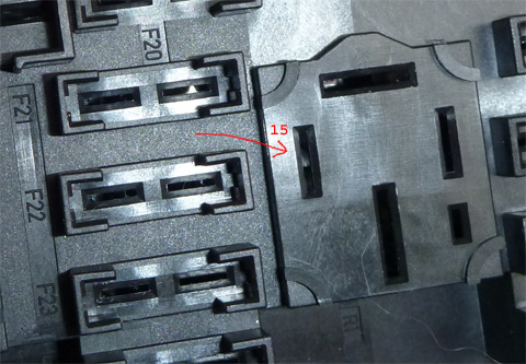

The relay has the part number 4H0951253 and, as mentioned, it's the only one located there.
Relays in the central electrical box, engine compartment.
In the spare parts catalog, the relay does not have a functional description; it only lists the relay number and the text "Relay".

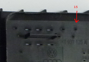

Pin 15, which is inserted into the central electrical box from below, has the number "15" printed on the central electrical box housing (see image).
"And I found it using the continuity tester at the connector at the top where you plug in the relay (picture)."
And so far, I've observed that there's always voltage present on pin 15.
I also once locked the car and left it for 2 hours with the hood open.
"It was left untouched and then measured (without unlocking or opening the door beforehand), and there was still electricity flowing through it."
Should I take measurements with the hood closed (running the measurement cable outside)?
 Zentralelektikkasten von oben - Relaisplatz des Relais 4H0951253.
Gekennzeichnet der Anschluss "15".
 File size:  84.08 KB
 Viewed:  36571 times
 Zentralelektikkasten von Unten (FlachsteckergehĂ€use).
An dem gekennzeichneten Pin steht "15"
 File size:  60.05 KB
 Viewed:  31985 times

Okay, you've clearly stated that you don't know the function of the relay. That's fine, it's a clear statement. I've taken a look. It refers to relay J317, "voltage supply to terminal 30".
The relay has the following pins: 30, 85, 86, and 87. Pin 15 is not available.
Pin 30 and 85 are connected to the battery.
Pin 87 is the output of the relay, to which all the "motor-driven components" are connected, which only receive voltage when the ignition is on (and during the engine's after-run). You can use this relay here.
Pin 86 is the relay's input. This is configured to provide the necessary current to energize the relay, causing it to engage. (You could also use the inverse configuration for your relay.)
Background of the relay: In a broad sense, terminal "30" of the motor is essentially the same as terminal "15". The motor can only power itself with voltage now, even though terminal 15 has already been disconnected (e.g., for the radiator fan after-run).
Note: The relay output (pin 87) connects to fuses 13, 14, 15, 21, 22, 23, and 24. These are the fuses located directly next to the relay. You would also need to measure that there is no voltage on either side of the fuse when the ignition is off.
Greetings.
Guste.
