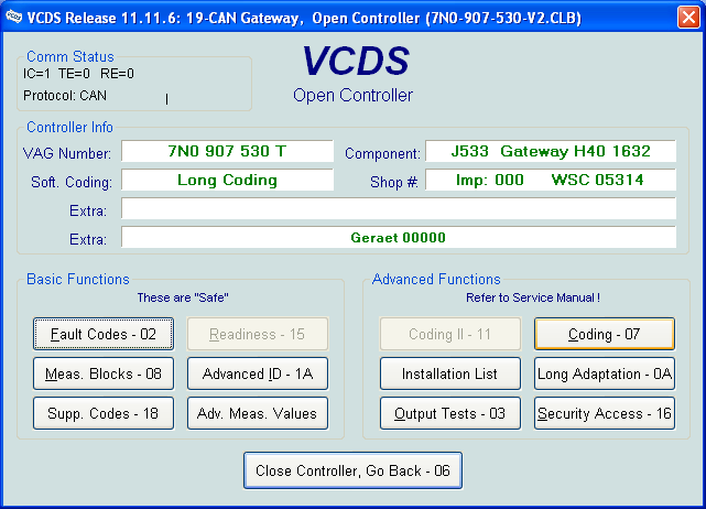

Hello.
I'm having trouble coding the Westfalia trailer hitch.
Volkswagen Passat B7, manufactured in 2012.
Monday, September 16, 2013, 12:32:18:27123.
VCDS Version: Release 11.11.6
Data version: 20121223

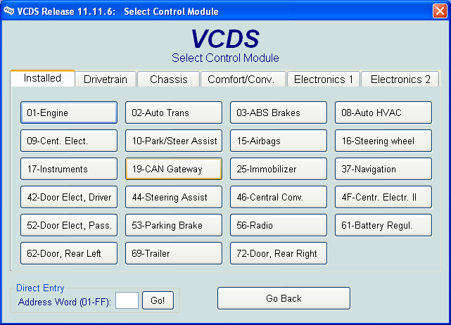

Chassis Type: 7N0
Scan: 01 02 03 08 09 10 15 16 17 19 25 37 42 44 46 4F 52 53 56 61
62 69 72
VIN: WVWZZZ
01-Engine -- Status: OK 0000
02-Car Transport -- Status: OK 0000
03-ABS Brakes -- Status: OK 0000
04-Steering Angle -- Status: OK 0000
08-Car HVAC -- Status: OK 0000
09-Cent. Electric -- Status: Sporadic communication error 1000.
10-Park/Steer Assist -- Status: OK 0000
15 airbags -- Status: OK 0000
16-Steering wheel -- Status: OK 0000
17-Instruments -- Status: Malfunction 0010
19-CAN Gateway -- Status: Malfunction 0010.
25-Immobilizer -- Status: OK 0000
37-Navigation -- Status: OK 0000
42-Door Elect, Driver -- Status: Malfunction 0010.
44-Steering Assist -- Status: OK 0000
46-Central Conv. -- Status: OK 0000
4F-Center. Electrical System II -- Status: OK 0000
52-Door Electric, Passenger Car -- Status: Malfunction 0010.
53- Parking Brake -- Status: OK 0000
56-Radio -- Status: OK 0000
61-Battery Regul. -- Status: OK 0000
62-Door, Rear Left -- Status: OK 0000
69-Trailer -- Status: Not registered 0001.
72-Door, Rear Right -- Status: OK 0000

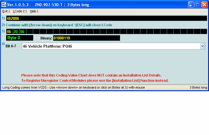

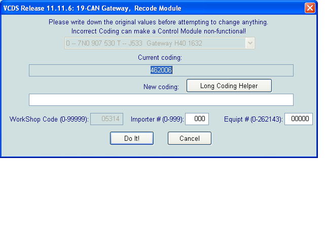

Address 19: CAN Gateway (J533) Labels: 7N0-907-530-V2.clb
Part Number (Software): 7N0 907 530 T
Part Number (Hardware): 7N0 907 530 K
Component: J533 Gateway H40 1632
Revision: H40
Serial number: 120612F1000927
Coding: 462006
Shop Number: WSC 05314 000 00000
VCID: 418326C1D8E039106F5
2 faults found:
00457 - Control Module for Network (J519)
004 - No Signal/Communication - Intermittent.
Freeze Frame:
Fault Status: 00110100
Fault Priority: 2
Fault Frequency: 1
Reset counter: 41
Mileage: 14,810 km
Time Indication: 0
Date: 2013.14.11
Time: 15:51:15
01044 - Control module incorrectly coded.
text
000 - -
Freeze Frame:
Fault Status: 01100000
Fault Priority: 1
Fault Frequency: 11
Mileage: 14,810 km
Time Indication: 0
Date: 2013.14.11
Time: 17:20:00

Post16-09-2013, 18:49    Subject: Tow Bar Wiring for VW Passat B7 Quote
I'm sure there's a place on screen 4 where I need to select the address "69 Trailer SG".
According to the instructions from AHK, check the box that says "AHK SG Encoded."

Post16-09-2013, 18:56    Subject: Tow Bar Wiring for VW Passat B7 Quote
Why use the English version of VCDS if you don't speak English?
Red doesn't get any redder than that.
You have to click on "Installation List", it says so.

Post16-09-2013, 19:17    Subject: Tow Bar Wiring for VW Passat B7 Quote
Because I only receive English versions as updates for my VAG COM set that I bought in 2006.
The instructions state "007 Coding" icon_redface.gif.
And because I didn't want to make many mistakes, I preferred to ask for clarification icon_redface.gif.
The installation of the list worked. icon_biggrin.gif Thank you. icon_wink.gif
