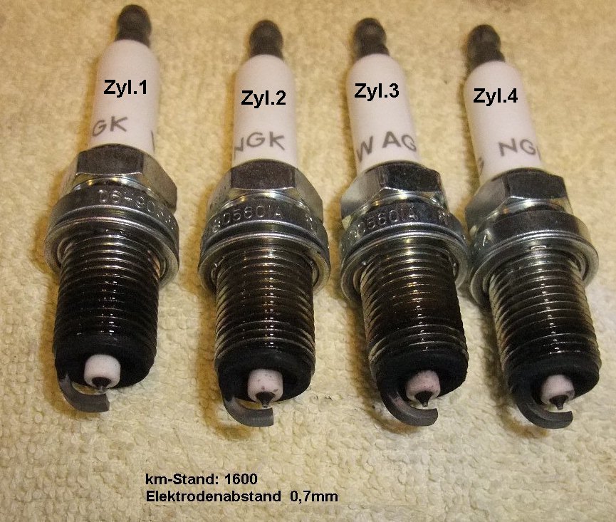

I once removed the spark plugs in the hope of finding clues related to the ignition system.
Previously, there was a rule of thumb that the insulator tip should be brownish in color, which indicated proper combustion.
Based on this, it seems my engine is running lean (see attachment). AFAIK, this increases the tendency for knocking, which in turn could explain the high specific wear rate.
Does that still apply to the 2.0 TSI engines?
My driving profile:
Mostly 2 x 20km per day, mostly country roads with several villages.
Approximately 50 km before I started modifying the spark plugs, I first drove him at a speed of around 80 km/h, as fast as traffic allowed, on the Autobahn, and on several occasions, I even exceeded 200 km/h.

"Fawn" used to be a common color, but these are mostly white.
| Back to top |

Okay, then mine probably look normal.
