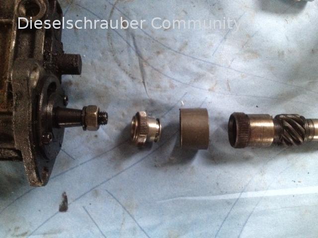

Normally, the pumps were driven via a coupling sleeve.
I installed and adjusted a PES...M system many years ago during my master craftsman's examination.
First, align the motor to its reference "Top Dead Center" (TDC) position, and do the same for the pump (approximately; fortunately, it has a side cover that allows you to see its orientation). Insert the pump, secure it with a screw/nut, and then manually inflate it using a hand pump.
Then, rotate the engine approximately 1/2 revolution against its normal direction of rotation (backwards), pump a little with the hand pump, and rotate it in the normal direction of rotation until the fuel delivery start mark (before the top dead center mark) is reached. At this point, the fuel level should rise at the high-pressure outlet for the first cylinder.
If you adjust it earlier, rotate the pump in the direction of rotation; later, rotate it against the direction of rotation. If you can't achieve the desired adjustment within the available range, you need to remove the pump again and shift the coupling sleeve or pump shaft by one tooth.
