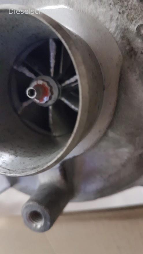

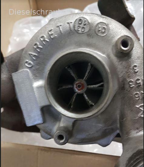

Hello everyone,
"My A3, with the BKD engine (2.0 140HP), recently suffered a turbocharger failure on the highway. Initially, it felt like a broken or clogged catalytic converter, as the boost pressure only came on much later. Upon disassembly, it was found that the shaft was okay, and the exhaust side appeared to be in order externally. However, the intake side had accumulated a significant amount of debris. The turbocharger repair specialist suspects that several plastic particles entered the turbocharger over a prolonged period from the crankcase ventilation system, although it's unlikely that foreign particles could have entered through the air filter." The entire system had been untouched for almost a year, and upon disassembly, it appeared to be in good condition - therefore, I'm ruling out the air filter as the cause.
Has anyone ever experienced something like this before? Does anyone have any experience with it? I would like to research and rule out possible causes before installing a turbocharger.
The issue occurred during relatively relaxed driving. At 140 km/h, the power suddenly reduced, but didn't completely disappear. With my previous turbo failure, it happened abruptly, including smoke. This time, there was no smoke and no unusual noises, leading me to suspect a slipped pressure hose or vacuum hose. I couldn't find anything wrong, so I drove a few meters while monitoring the target vs. actual boost pressure via OBD, and noticed that the turbocharger was building pressure with a delay.

Hello Steffen,
I'm not aware of anything comparable in the Audi A3. Is the mother that the compressor wheel is screwed onto still in place? I can't really tell from the picture.
If this came loose, it could have caused the damage. Or maybe not, it's all speculation. My suspicion is that the mother would have disassembled everything in the same way.
Regarding foreign plastic particles from the cooling water system, I am not aware of any issues. However, I would still replace the cooling water system with the oil separator as a precautionary measure.
