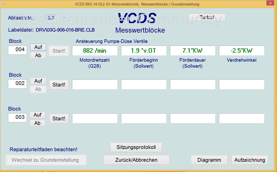

I have some elongated holes in the camshaft sprocket. /viewtopic.php?t=26285
I need to check the twist angle/synchronization angle on my setup. I think I intentionally set it slightly away from "zero" – if that was the wrong direction, that would be a problem...
Edit: Okay, it seems I was right after all, so "-" indicates early!
