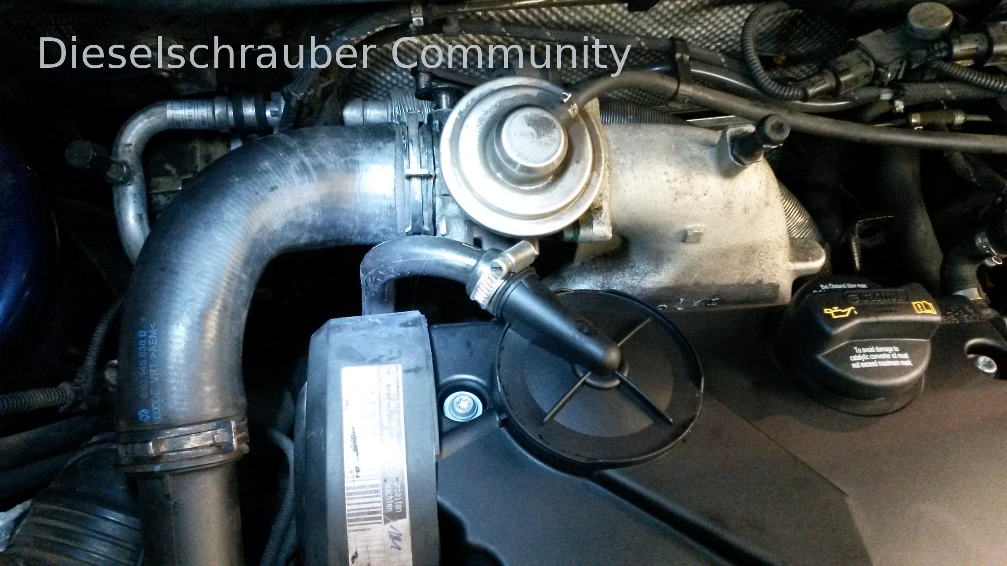

I'm having trouble with an oil leak on the valve cover.
I replaced the gasket (Elring), installed it dry, but it still leaked.
Then I applied sealant (Dirko Gray), but it's still leaking near the screws on the back.
Does anyone have a tip for me? Not enough packing material?
The hood itself has already been replaced with a used one.
Regards,
Adrian.

Either the hood or the VDD is also defective, or there were errors during installation.
Normally, the sealant is only applied to the joints of the NW bearings.
Possibly, the leak is actually located somewhere else, and the oil then flows like a stream to the lowest point, where it drips off.
So... Remove the lid and take a look.

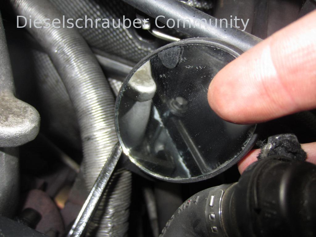

That was already the second attempt with two used hoods, so I went to icon_biggrin.gif and bought new ones. I hope this will be leak-proof now.
But there's a new problem: the bleeder fitting has a different angle, and the bleeder hose could only be mounted under tension. Is it possible to rotate the fitting? I don't want to force it or try to make it work by any means necessary, otherwise those 122 euros will be gone very quickly...

Can the sock be turned inside out?
I don't think so.
Certainly not.
Skoda Octavia III Combi (5E5), EZ: 6/2016, 2.0 TDI 110 kW (MKB: CRMB), 6-Gang-Schaltgetriebe (GKB: PGT)
Joined: 09/17/2004
Posts: 1833
Location: Frankurt
dieselschrauber likes this.
Post29-10-2015, 22:02    Subject: Cylinder head cover leak AMF Quote
Alternatively, carefully heat the rigid plastic tube with a hot air gun; it will naturally take on a more relaxed shape. icon_idea.gif

I'd like to provide some feedback: The ZK hood was returned because the ventilation was incorrectly glued/welded.
After checking, I received a new one icon_smile_thumb_up.gif.
The new cooker hood design has different screws, the seal is thicker, and it is, above all, leak-proof icon_smile.gif.
