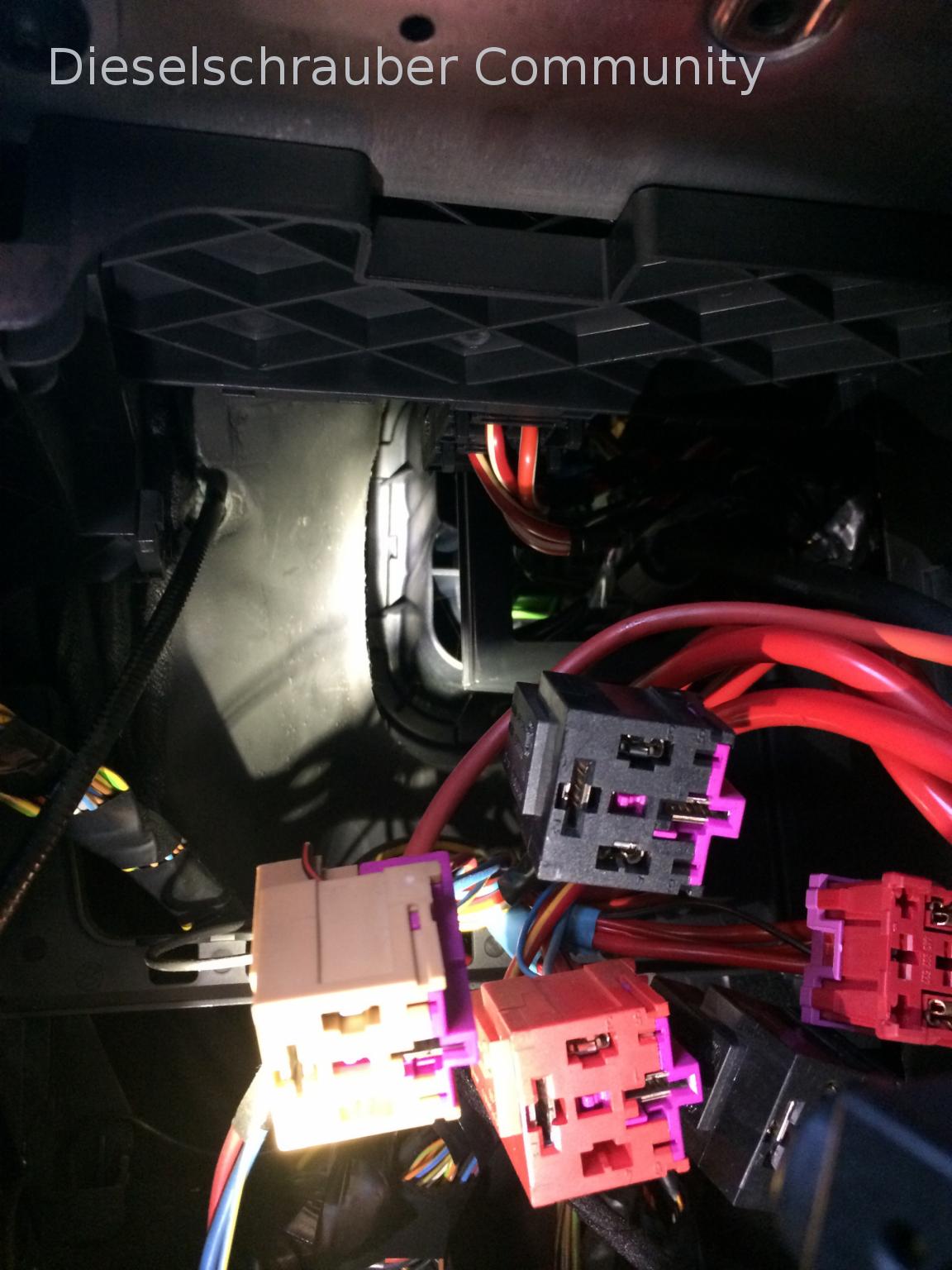

29-11-2016, 22:12 Subject: 40A Fuses: Find 2x for Your Project |
Quote |
Today, I found two 40A fuses located outside of the relay holder. The cable colors seem to correspond to the heating system.
Where could the third fuse be hidden?
In the wiring diagram, after the fuses, you will find the following connection:
A152 - Connection -5- (87), in the distribution panel wiring.
where can I find this connection?

I was mistaken; the fuse I found is only one. The black part in the middle of the fuse is a locking tab. According to the wiring diagram, this is fuse S276. The rt/ge cable connects to a red wire here. This is the fuse for the first stage. The other two stages are, according to the diagram, separately fused with S277/S278. Unfortunately, I can't find either of those two fuses or the connection A152 behind them. I would have to remove the entire dashboard to expose the wiring. I'll try to see if I can identify anything more by removing the body control module, the relay block, and the distribution box. That should be relatively quick.

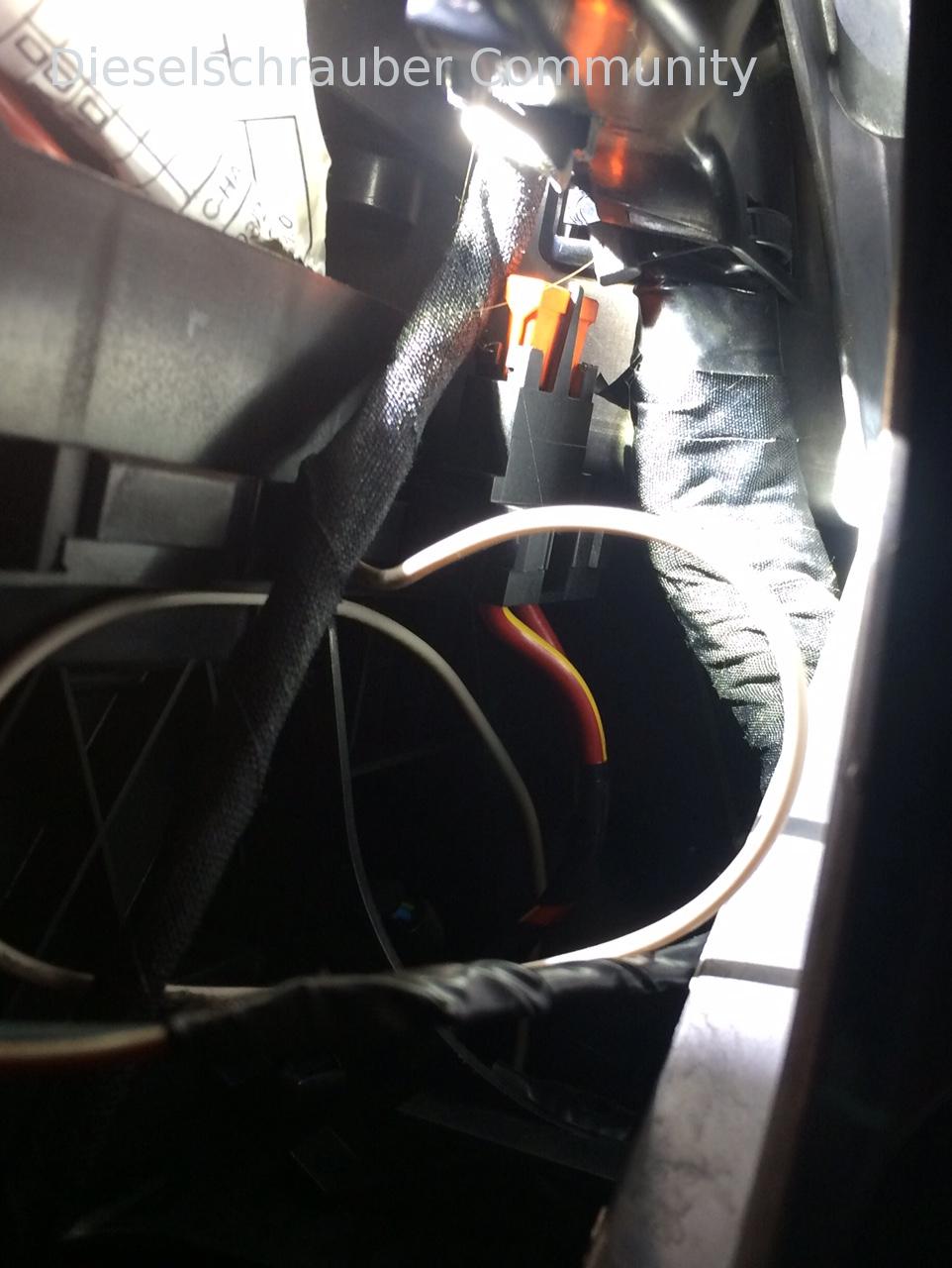

04-12-2016, 21:53 Subject: Heating System Running: Troubleshooting & Tips |
Quote |
I have now removed the body control module and the relay holder and found the other two fuses behind them. Then I connected the ground connection, and sure enough, everything is working.
The initial questions remain unanswered. However, at least the car will now warm up quickly.
Greetings, Jens.
