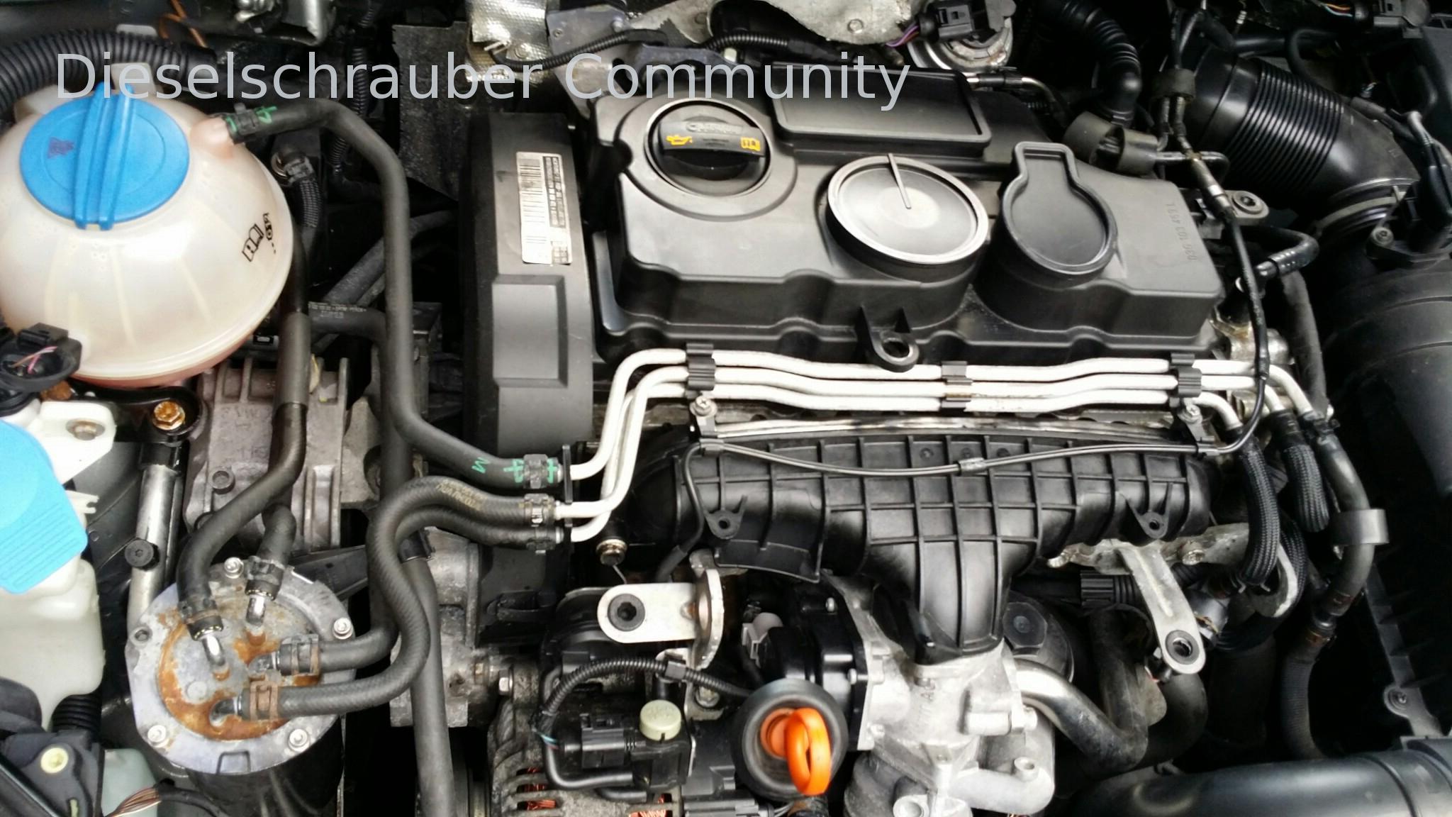

Hello diesel mechanics,
I have an exciting story for you and I really need your help.
"For a few months now, we've been borrowing our in-laws' well-maintained VW Passat Variant 2.0 from the year 2006, and we certainly don't want to return it as a total loss."
The increasingly erratic driving behavior and the smell had long indicated that something was not right. However, several workshops, including two VW specialist workshops, had already repeatedly and unsuccessfully searched for faults or causes. In the process, parts were repaired and replaced that were not actually defective, and the actual fault has remained.
Symptoms:
- The engine usually takes longer than normal to start, and it sounds irregular during the starting process.
- Erratic idling and low-gear behavior (engine speed fluctuates).
- Spontaneous, wave-like or jerky acceleration (in 3rd gear at 50 km/h).
- Sometimes the car drives so roughly that you can feel the jolts in the steering wheel and get shaken up.
- An enormous, persistent stench (biting, toxic, smokeless - like a suffocated barbecue).
    Error memory:
No errors found that correspond to the symptoms. The only error code that should be mentioned for the sake of completeness is: P0299 - 006 - Boost pressure control, limit below threshold.
"This error could be reproduced: when accelerating in 6th gear at 2200 rpm, the turbocharger could no longer reach the desired boost pressure, and the engine went into limp mode. Consequently, the air ducts/lines were replaced, and the seals were renewed."
The problem with the turbocharger pressure regulation seems to be resolved, but the symptoms (smell, erratic running) persist.
Serious new evidence:

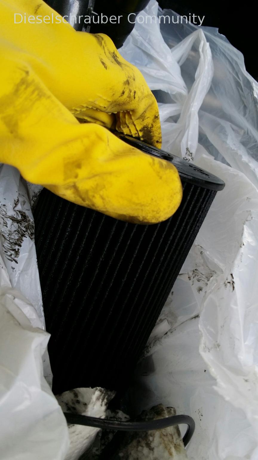

Yesterday, while changing the air filter and diesel filter, there was a nasty surprise: The diesel filter was completely clogged with black oil. We had seen something similar before community.dieselschrauber.de/viewtopic.php?t=267488O, where a crack in the tandem pump was suspected.
(A check of the current oil level was okay.)
During the first short test drive after replacing the filters, without having driven any kilometers, the turbocharger's power completely disappeared without any error messages, accompanied by strong, white clouds of smoke from the exhaust that smelled like plastic. --> Is the turbocharger dead? [url] [/url]
Attached is a VCDS log/recording from that trip without the turbocharger.
Tomorrow, we will have to open everything up and disassemble it (turbocharger, tandem pump, etc.), without having a clear idea of what caused all the previous symptoms and the final failure.
Debugging can be very expensive, and the repair, if you rely on the wrong information, is even more so. Due to the lengthy history, many people have already been racking their brains, so now it's time for the real professionals to step in icon_cry.gif.
Thank you very much in advance.

Hi!
What is the mileage of the Passat?
Engine identification codes?
Last service?
It seems like the vehicle has been somewhat neglected.
"When I look at the fuel filter!"
I wouldn't just ignore that error message!
Try accessing the VTG (Valve Train Geometry) in the actuator diagnostics!
Perhaps this will help!
Und mal die unterdruckschläuche kontr. Maderbiss??

Good evening.
when I look at the fuel filter!
Not particularly helpful statements! icon_rolleyes.gif He had written that engine oil was in the diesel filter. You can "wait" as little or as much as you want, but that normally doesn't get in there.
The engine is a 170 hp TDI with Piezo common rail injection (Siemens VDO, now Conti). The engine code is BMR.
My suggestion would be, in addition to checking the tandem pump, to examine the idle speed control values (MWB13) and the injector switching times (MWB23).
The amount of air being drawn in is far too low. Are the throttle valve and EGR valve functioning correctly?

Post28-09-2015, 10:43    Subject: Turbodiesel Failure: VW Passat 2.0 - Symptoms & Causes Quote
Hello Mags,
It's possible that the problem lies with the turbocharger boost control, the unusual power delivery, or the regeneration issues (smell) are consequences of the temporarily low air mass values.
I'm rooting for you!
There's still the issue of the black sludge in the diesel filter, and the tandem pump needs to be checked.
Edit: The above applies if the filter shown is actually the diesel filter. However, in the first picture above, it can be seen that the diesel filter is screwed on. The oil filter and the diesel filter look very similar in this model, as shown in the picture. I have been informed that the filter shown is supposed to be the oil filter, but this is difficult to discern from the picture.
I assume, hopefully, that no one is tinkering with an engine while confusing the oil filter with the diesel filter...

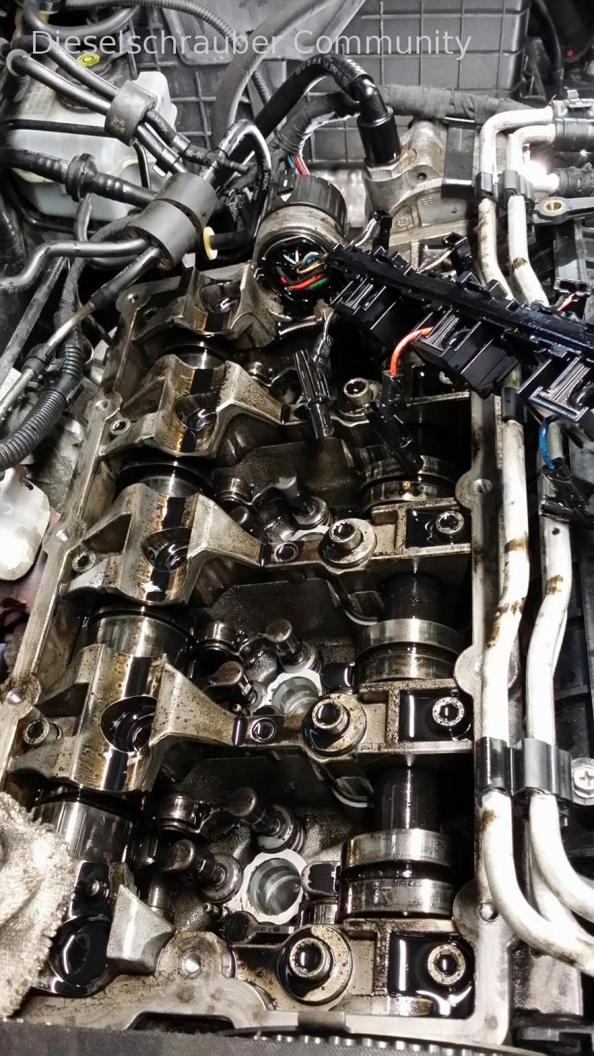

Hello, dear Diesel Mechanic Team,
Thank you very much for your helpful answers back then.
The Passat 3C still exists, but don't ask about the price icon_confused.gif; in this case, it was more about the principle icon_wink.gif.
We then tried to get to the bottom of the cause of the errors (primarily the wavy/jerky acceleration) by any means necessary - which ultimately led to us completely replacing the engine . Here is a brief summary of how it happened and what we did:
    - First, we updated the software on the control unit.
    - and replaced the wiring harness of the PD (Pressure Diode) elements.
    - After that, we had the PD elements professionally cleaned at VW.
When everything still didn't improve, and the wave-like acceleration up to 2500 RPM persisted, we...
    - Have the PD elements at VW specifically checked -> two of them were very clogged despite cleaning.
    - At the same time, we inspected the cylinder head gaskets and found a crack in a cylinder wall. icon_eek.gif icon_cry.gif
At this point, it would have been the right time to dismantle the car for spare parts, but we had obtained a new engine (80,000 km) at a very good price, and we thought we could overcome everything with it.
    - Installation of a new engine (including turbocharger).
    - Cleaning of the DPF
The new engine ran very smoothly after installation, as expected, but as you might guess: the good luck didn't last long. icon_confused.gif
More on that in the next section.
Best regards,
Mags.
