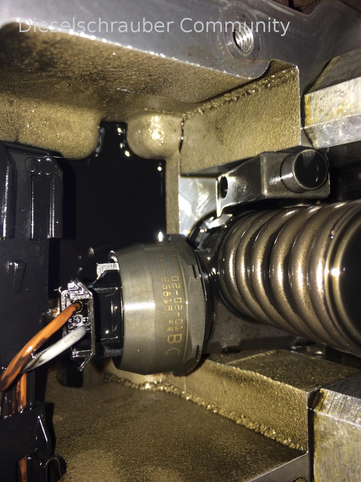

Thank you for the quick help. I just inspected the ZKH (presumably a component or system) and saw that three PD (presumably a type of component) housings in the ZK (presumably another component or system) have been cleaned by the escaping diesel fuel. (Photo)
I don't think the engine has a piston problem; it accelerates well and reaches its top speed. I'll replace the seals in two months, as I'm getting a Touran then, and I need to keep this car running until then.
Thank you, Rainer. Best regards, Wolfgang.

It would be very interesting to see what the values look like after the procedure.
Right now, it looks like this to me:
PDE2 and PDE3 are internally blocked and mechanically damaged; PDE4 is on its way to being the same. Only PDE1 is still functioning properly.
The lean-out regulation attempts to keep the slower injectors working properly by providing them with more fuel. PDE1 roughly compensates for this amount. That's why there are such high negative values.

I have sealed all the injectors, changed the oil, and the smoke from the exhaust has disappeared. I moved the injector from cylinder 1 to cylinder 4, the injector from cylinder 2 to cylinder 4, the injector from cylinder 4 to cylinder 1, and the injector from cylinder 3 remains in its original position.
I checked the log, but it didn't work at a higher speed. I hope the Passat will last for at least another two months.
I will no longer install new Positive Displacement Elements (PDEs) in this worn-out control head. However, even when I remove the oil filler cap, there is still a lot of pressure in the engine.
