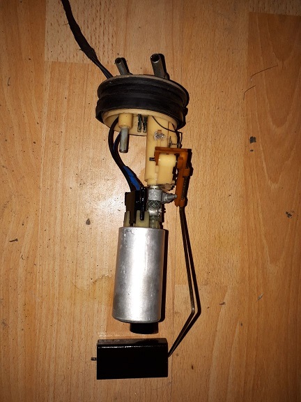

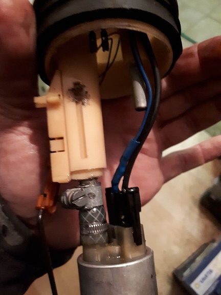

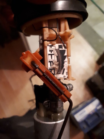

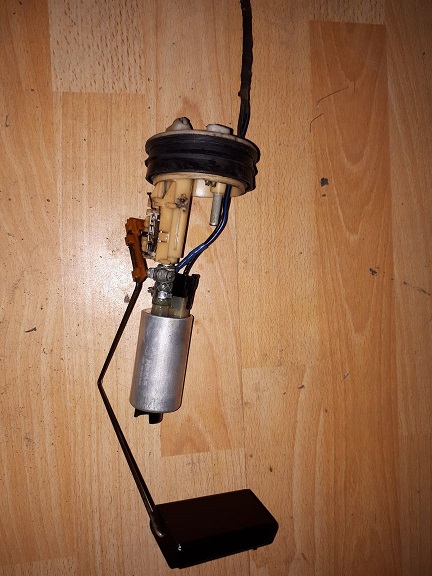

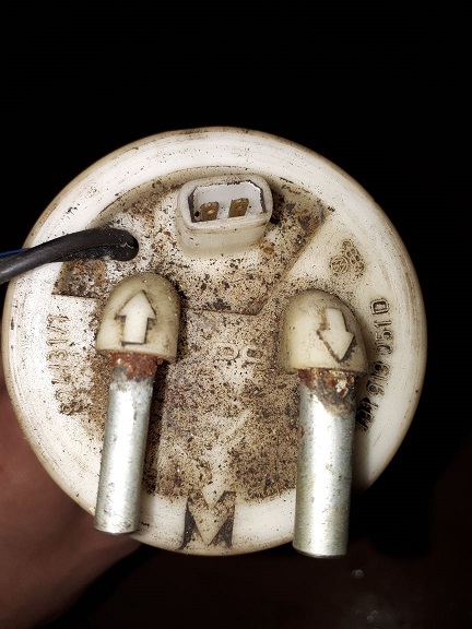

Today, I visited someone who has a 1.9-liter pump-injector engine (130 horsepower, 5-speed) installed in their second-generation Golf. Unfortunately, he already bought the car like that, and he couldn't help me with the details.
However, I was able to convince him to temporarily remove the built-in fuel pump icon_smile.gif.
It has an original Golf 2 fuel tank installed (with the small opening), and a diesel fuel filler neck.

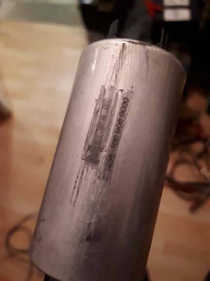

The fuel pump installed is a modified fuel tank unit from a Volkswagen Golf 2 (1.6L). Unfortunately, I can't find any information about the specific pump model, and the markings are difficult to read. I've tried to enhance the existing markings, and I can make out something like "Mezle" or "Mekle," along with the number 456 100 906 0000. The pump receives power through two separate cables. The original connector is then used for the fuel gauge.
Unfortunately, I can't find any information about this pump online, and I'm not familiar with the brand. It would be interesting to know how much pressure the pump generates. Does anyone know this brand?
Anyway, this combination or "hack" works quite well; the colleague has no problems, and everything functions 100%.
If I knew where to get the pump, I could replicate it exactly icon_smile.gif.
Regards,
Joe.
 Links eine Originale Golf 2 Pumpeneinheit, rechts die "Modifizierte" Einheit mit der unbekannten Pumpe.

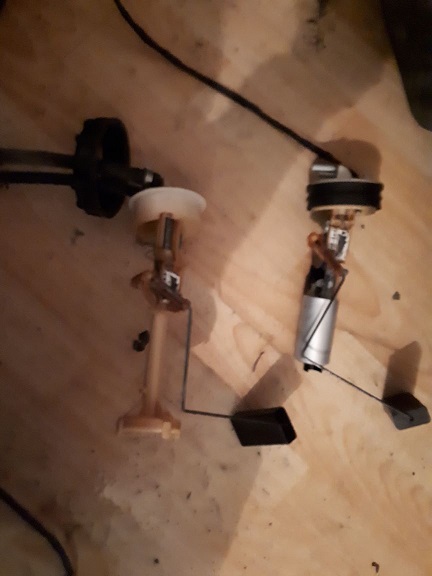

In the image 5.jpeg, if you look closely and pay attention, you can actually read the VW part number on the right side.
With the poor image quality, I can already see **1,913,051 D.**
Gremlin

Post03-11-2017, 2:13    Subject: Golf 2: Which fuel pump for ARL engine conversion? Quote
Just like the cables simply pass through the lid...
I don't think this solution is good.
191919051D is the number you mean, Herbert icon_cool.gif.
If possible, I would like to install a fuel level sensor for the injector; I think it should be feasible.
Sure, please provide the text you would like me to translate from German to English.
191919051AP
In older central electrical systems, the fuel tank sensor and the pre-lift pump often share a common ground.
Alternatively, the...
TN 191919051AT
compatible; installed in new central electrical systems, with separate grounding terminals.

Post03-11-2017, 20:17    Subject: Golf 2: Which fuel pump for ARL engine conversion? Quote
Hello.
The pump in the picture is from an Audi A6 4B 2.5 TDI icon_wink.gif.
Part number 16116754762.
Back pressure from 0.5 to 3.0 bar.
Regards, Mpire.
Joined: 06/22/2005
Posts: 4636
Post03-11-2017, 20:29    Subject: Golf 2: Which fuel pump for ARL engine conversion? Quote
The lid in picture 5 does not belong to the pump, does it?
Mpire
Avatar-Mpire
Joined: 10/19/2009
Posts: 351
Location: Oberpfalz
2019 Skoda Octavia
Post03-11-2017, 20:49    Subject: Golf 2: Which fuel pump for ARL engine conversion? Quote
Joe wrote:
The fuel pump installed is a modified fuel tank unit from a Volkswagen Golf 2 (1.6L). Unfortunately, I can't find any information about the pump used, and the label is also difficult to read.
Regards,
Joe
He took the fuel filler cap from a Golf 2 and "attached" a TDI pump from an A6 to the bottom of it.
...but for cable routing, there are truly "more elegant" and then also more airtight solutions icon_lol.gif.
Regards, Mpire.
Joined: 06/22/2005
Posts: 4636
Post03-11-2017, 21:38    Subject: Golf 2: Which fuel pump for ARL engine conversion? Quote
