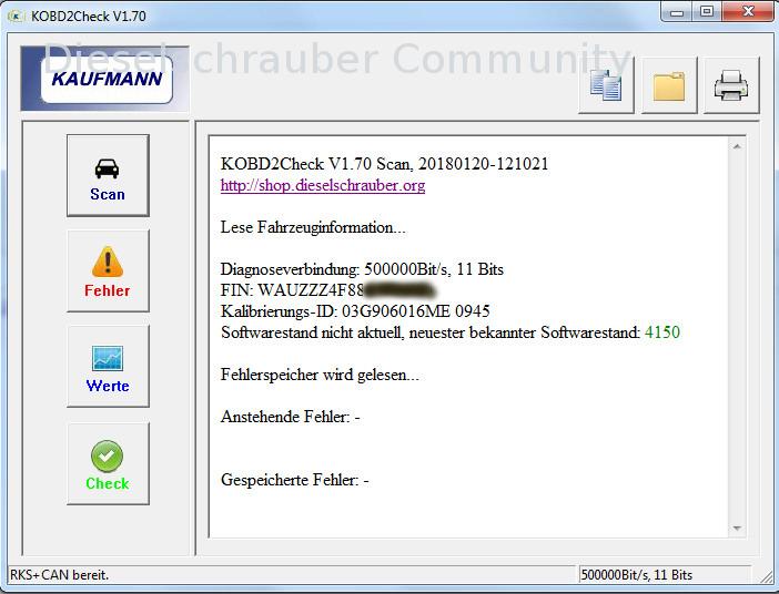

A test version of KOBD2CHECK, which provides information about newer software versions and indicates whether an existing CVN is genuine (i.e., the engine control unit software is original), is complete. icon_razz.gif
Download: see attached .rar archive. Please note that the trial version only works with the Diesel Mechanic RKS+CAN interface. This is included with the "OBD2 Diagnostic Kit" and the "CAN-USB Interface Kit". icon_idea.gif
In order to display the information, KOBD2CHECK needs internet access. To start the scan, click the [Scan] button in KOBD2CHECK.

Post18-01-2018, 17:55    Subject: Engine Control Unit (ECU) software version and chip tuning check Quote
Is that just an example in the Screenshot?
For this part number, the software version is 4150.

Post18-01-2018, 18:44    Subject: Engine Control Unit (ECU) software version and chip tuning check Quote
The following software versions are available for product 03G906016ME: 0945, 1141, and 4150.

Post02-02-2018, 19:48    Subject: Engine Control Unit (ECU) software version and chip tuning check Quote
The calibration ID seems to be outputted in different formats...
I would be grateful if you could provide me with the results of a KOBD2Check scan (see the image "ECU-software-check-KOBD2Check.jpg" above).
