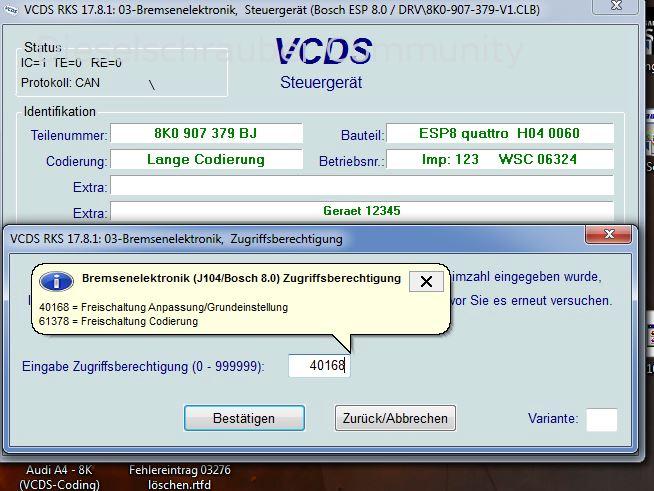

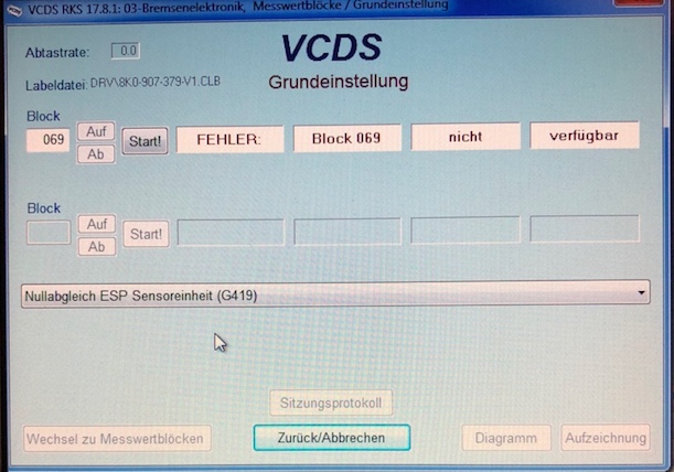

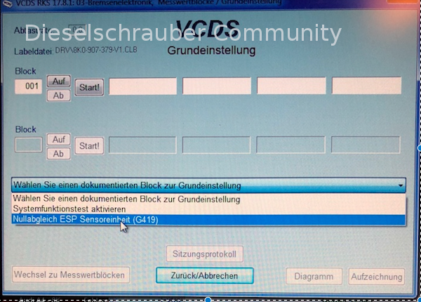

What prerequisites must be met to perform the calibration of the crankshaft position sensor (ESP)?
Currently, VCDS v17.8.1 is only showing "not available" as an error message in the basic settings menu under the "Brake Electronics" control unit.

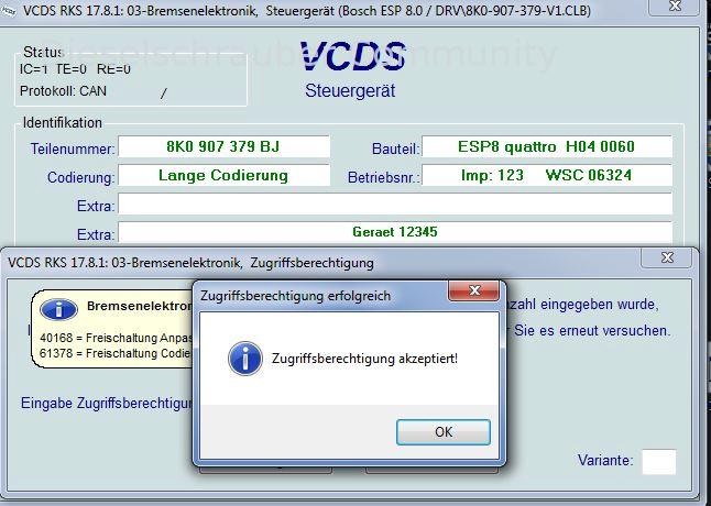

Login code has been entered and accepted previously.
The vehicle was also parked on a flat surface.
"Thank you!"
The vehicle is an Audi A4 8K with a sport differential (equipped with two wheel speed sensors).
Here's the car scan:

Post18-12-2017, 16:20    Subject: ESP Sensor Replacement: Calibration Needed? Quote
What prerequisites must be met to perform the calibration of the rotational speed sensor (ESP).
Currently, VCDS v17.8.1 displays "not available" as the only error message in the basic settings menu under the "Brake Electronics" control unit.
Login code was previously entered and accepted.
Okay, assuming that there are no errors in the relevant control units and that everything is functioning as it should.
Did you enter the correct code to unlock the default settings?
Could you please post a picture showing the basic settings channels you have?

Post19-12-2017, 20:21    Subject: Bremselektronik: Bilder für Standard-Auswahlmenü Quote
Attached are the images (two of them were photographed because of problems with the Snipping Tool).

Post20-12-2017, 10:08    Subject: ESP Sensor Replacement: Calibration Needed? Quote
Okay, sounds silly, but everything seems plausible. I'll check with the manufacturer.
