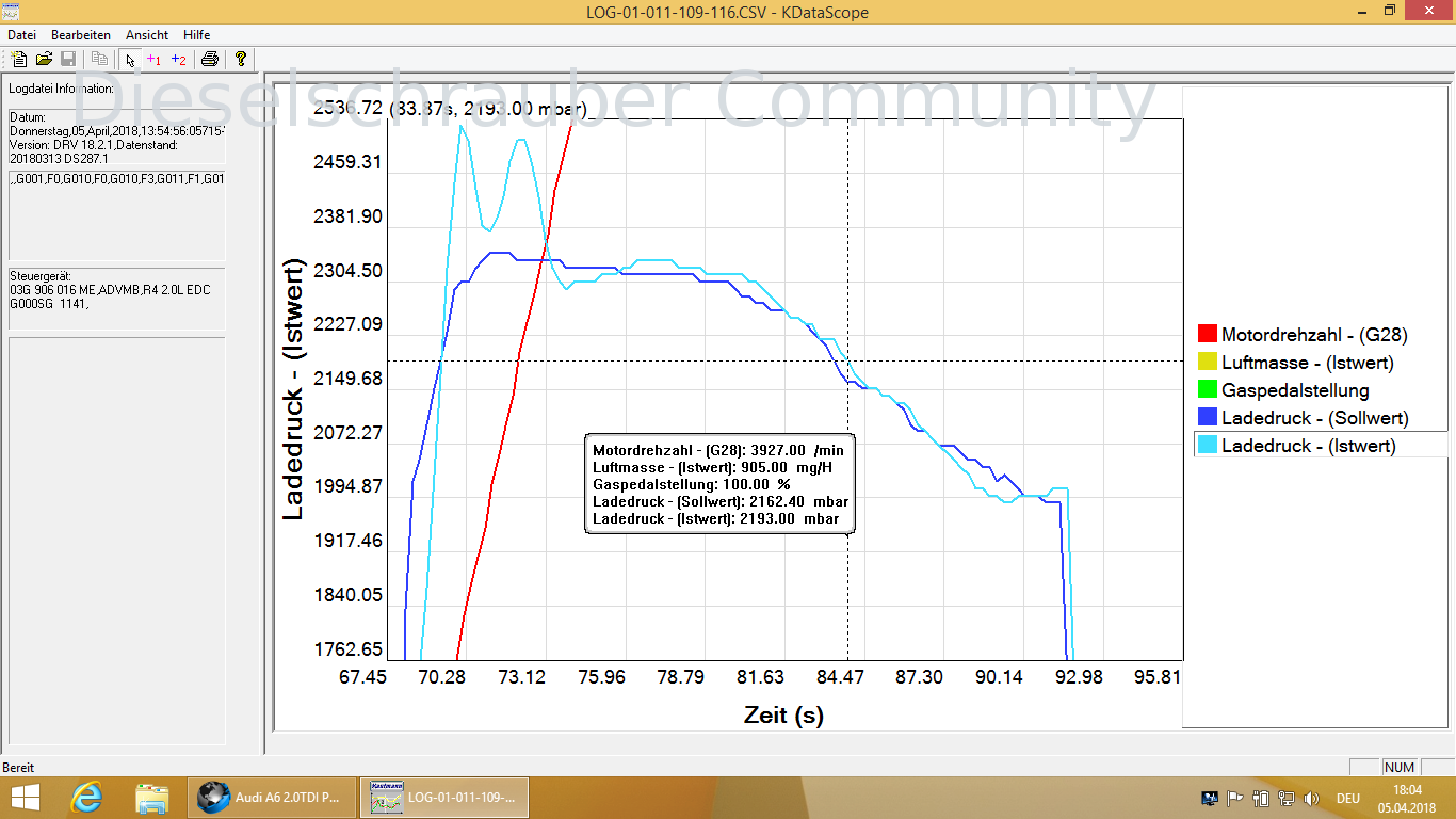

Based on both the actual air mass values and the charge pressure control, it doesn't appear there's a significant leak in the charge air system.

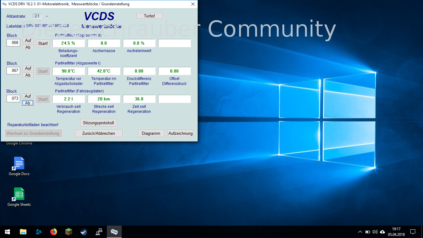

What value do you see for the differential pressure at the DPF when the ignition is on but the engine is off?
What ash mass value did you set in the engine control unit after replacing the DPF?
What is the current ash mass reading that the engine control unit (ECU) sees? (This should be measurement block 68.)

I repeatedly observe a lag in the boost pressure, both when accelerating and decelerating.
While it may not seem relevant to the current problem, isn't this an indication of a pending VTG (Vehicle Train Graph) update?

Yes, it seems acceptable, although the VTG (variable transmission gear) might be slightly dirty, but it's not a VTG-related issue.
I had to replace the AGR valve and throttle body several times in my car, but I was able to do so affordably by using compatible parts from the aftermarket.
Possible causes for the rapid DPF filling could also include issues with the AGR system, but in my case, the error light and limp mode came on immediately when the problem occurred. Voluntarily, you won't be able to travel very far with only what feels like 50 horsepower.

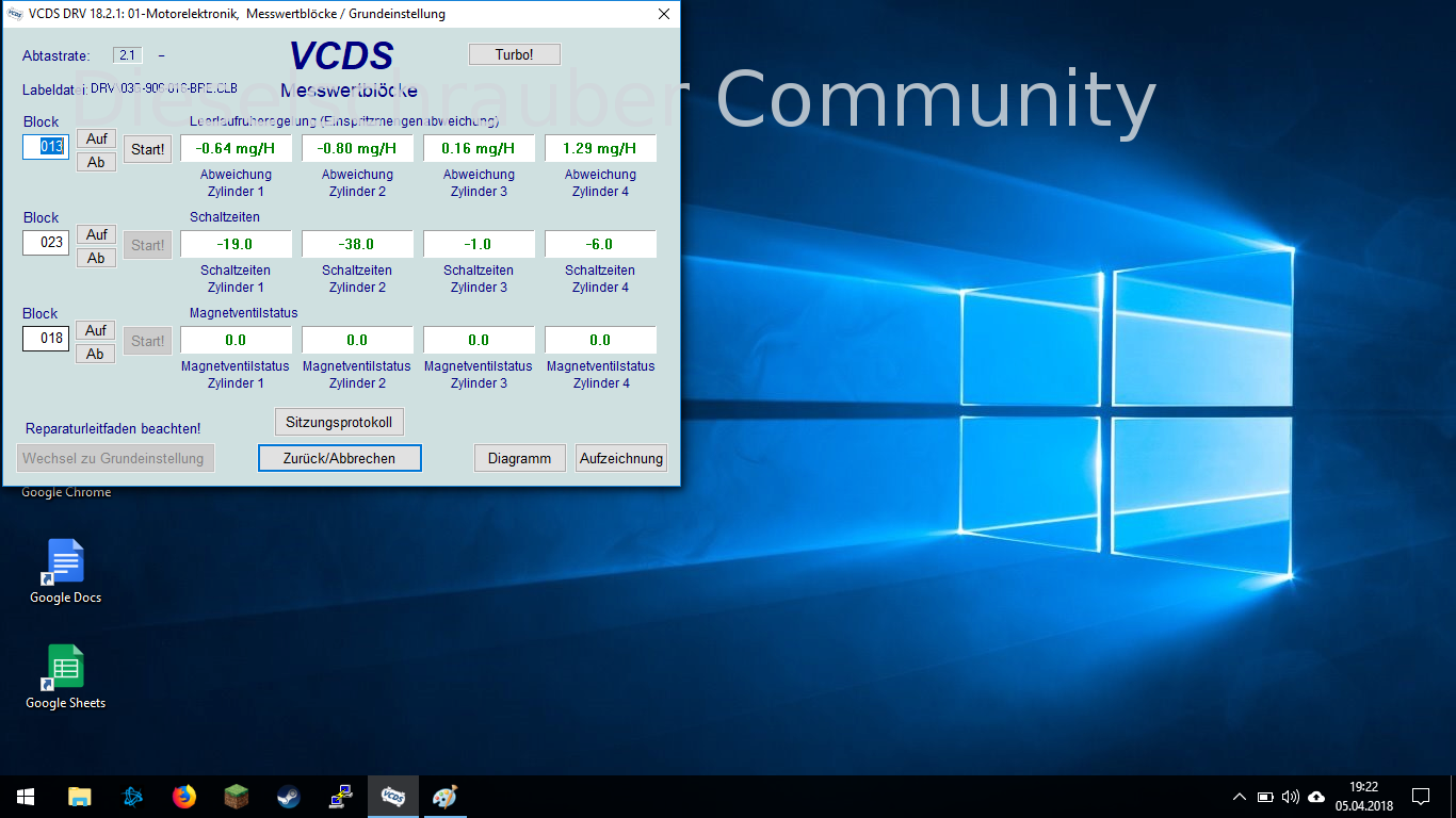

Possibly check the idle speed control for any anomalies (measurement block 13).

1. Diff. Engine pressure: 0.00.
2. The ash mass value cannot be entered.  I tried to adjust the hexadecimal value for 5g in the long adjustments of channel 12. However, nothing I enter is accepted. Ash value always remains at zero (Am I doing something wrong?)
3. Ashmass remains at zero.

"When I keep the engine at an idle speed of 1500 RPM in regeneration mode, I experience excessive smoke. This also happens during driving in the load change range. As the load and RPM increase during acceleration (not full throttle), the smoke decreases..." I'm posting a Screenshot of MWB 13.
I also saw that he administers an additional 20mg/hour during the regeneration process. Does the amount seem right?
Rainer:
AGR is new and is a brand component. The throttle body has been cleaned. I also don't have any errors in the ECU.
By the way... The MWB 18 magnetic valve status shows 128 when I release the accelerator pedal while driving. As soon as I press the accelerator, the "128" disappears.

Ash mass is 0, okay. Idle speed control values are normal.

Question: How does the display value of the DDS behave? Does this display the absolute pressure difference, or is the displayed value calculated based on the ash mass?
The reason for my question is: After replacing the DPF, I couldn't set a value for the ash mass; only "NULL" was possible. If the DDS value depends on it, that could be a possible explanation for the frequent regeneration, right?
