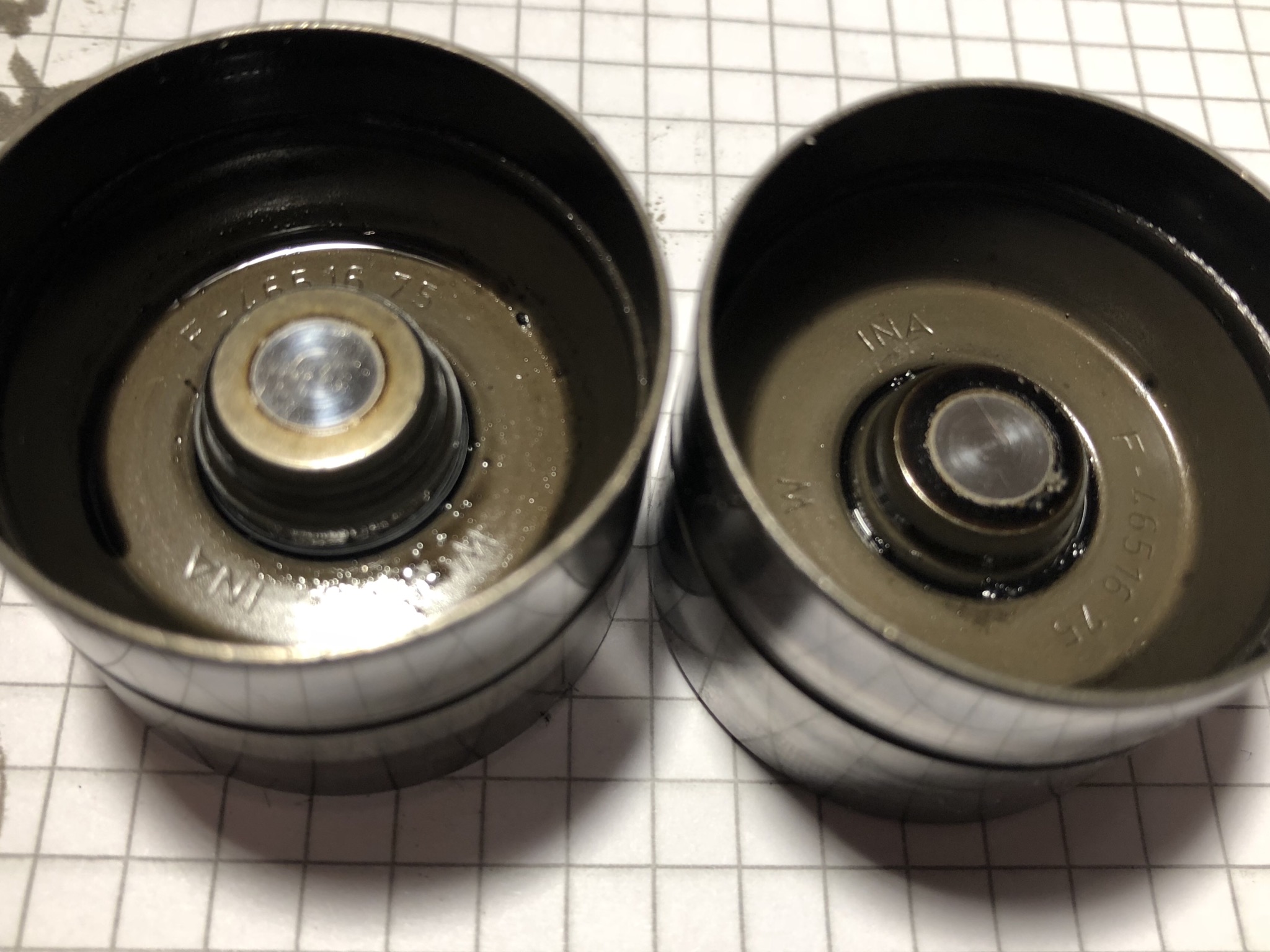

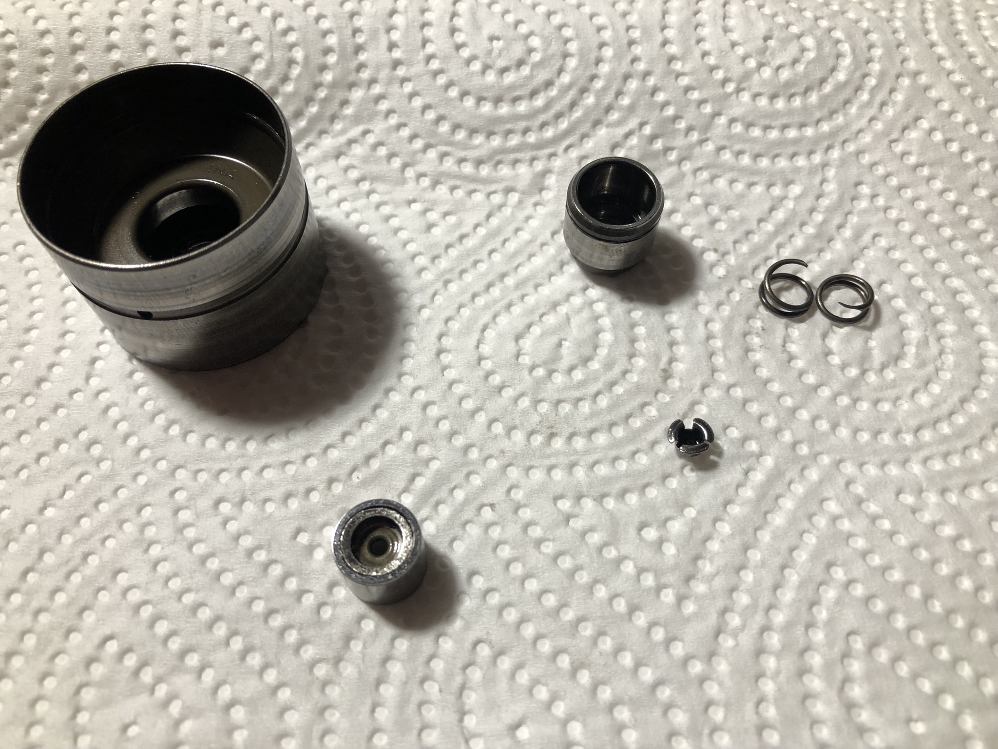

Hello, I'm having a problem with my Audi A4 B7 2.0 TDI (BPW) where the old camshaft was worn down on the 6th valve, specifically the tip was gone. So, I replaced all the lifters, all the bearing shells, all the screws, and the camshaft with new parts from Kolbenschmidt. However, I just couldn't shake the feeling that something else might be wrong with the engine. So, I removed the valve cover, and what do you know? The cam lobe and lifter number 6 show clear signs of scratching. What's curious is that I've looked at several similar cases, and almost always the cam lobe on the 3rd cylinder is worn. Is this a design flaw?
Does anyone have any ideas what the problem might be? Could it possibly be a problem with the valve? The lifter looks like it's being crushed between the valve and the camshaft.
Before I start tearing things apart, I'd like to measure the oil pressure at the location of the oil pressure sensor. Does anyone know what values I should expect under different conditions?
 Die Feder davon war auch zerbrochen.

 links ist ein anderer Stößel und rechts das vom Ventil 6. der ist gedrückt und hat sich schwarz gefärbt.
 File size:  455.67 KB
 Viewed:  3092 times
 Stößel eines anderen Ventils

Post20-04-2018, 16:01    Subject: Camshaft Wear: New Part Failed Quickly? Quote
Is the packing in the valve stem shaft still in place and sealing properly? If not, the oil pressure will be lost there.
