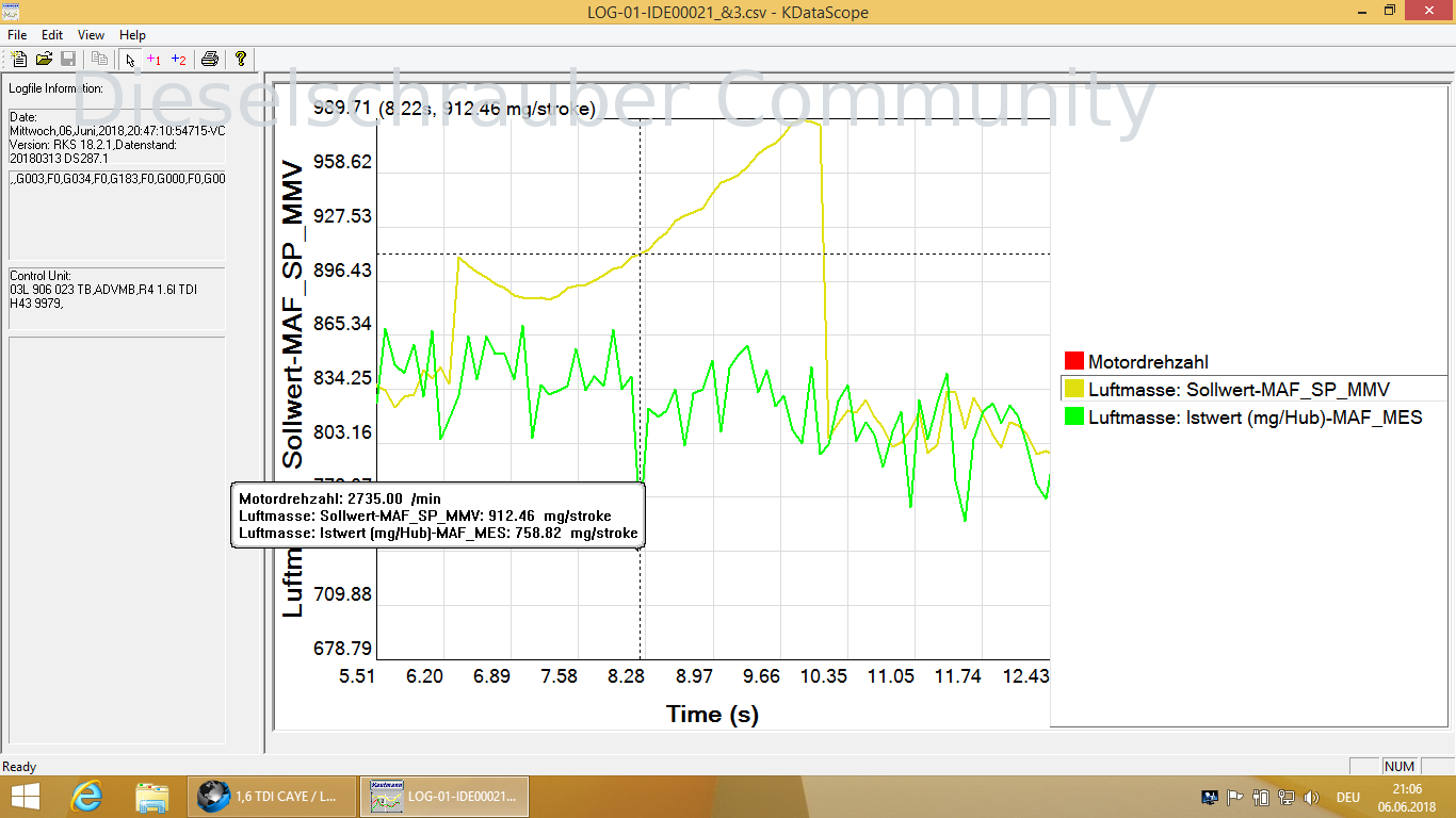

Post06-06-2018, 20:53    Subject: TDI CAYE: LMM Error After Replacement - Low Power Quote
Sorry, beginner's mistake...
Here, only third gear, full throttle, from 1000 RPM to 4000 RPM.

Post06-06-2018, 21:14    Subject: TDI CAYE: LMM Error After Replacement - Low Power Quote
"The logs show drops in performance, and besides that, the values at full throttle are below the target values. I'm not sure if this is normal for 1.6 TDIs, but at full throttle, the actual values should ideally be above the target values."
It's possible that the emissions update is also a factor here.
LMM is 100% sure to be the right choice and comes from the icon_smile.gif instead of a parts source that sells printed cartons on demand?
In the past, especially with LMM (likely referring to a specific product or company), it was common for people to be scammed and sold items that were essentially scrap metal (more or less functional LMM knock-offs).
Regarding the decreasing values: I would like to examine the LMM wiring, millimeter by millimeter, to check for any damage or cable breaks.
Don't forget to wiggle the plugs.
You can also let the engine idle and try to trigger the sensor errors by bending or wiggling the connectors and cables.
Another possible, albeit unpleasant, cause could be a faulty EGR valve or a defective throttle valve. However, before investigating further, I would definitely make sure that the connectors, wiring, and mass airflow sensor (MAF) are all in good condition.

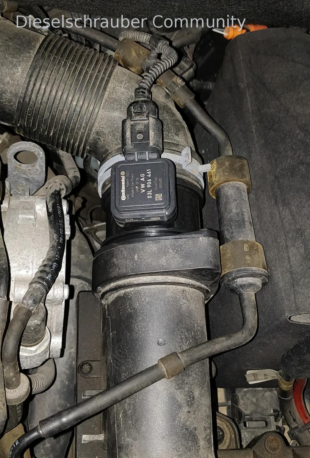

Here's some information about the new LMM, including a picture. It was purchased directly from the parts counter.
 File size:  2.43 MB
 Viewed:  1030 times
Translated on 30-08-2026, 19:11.
