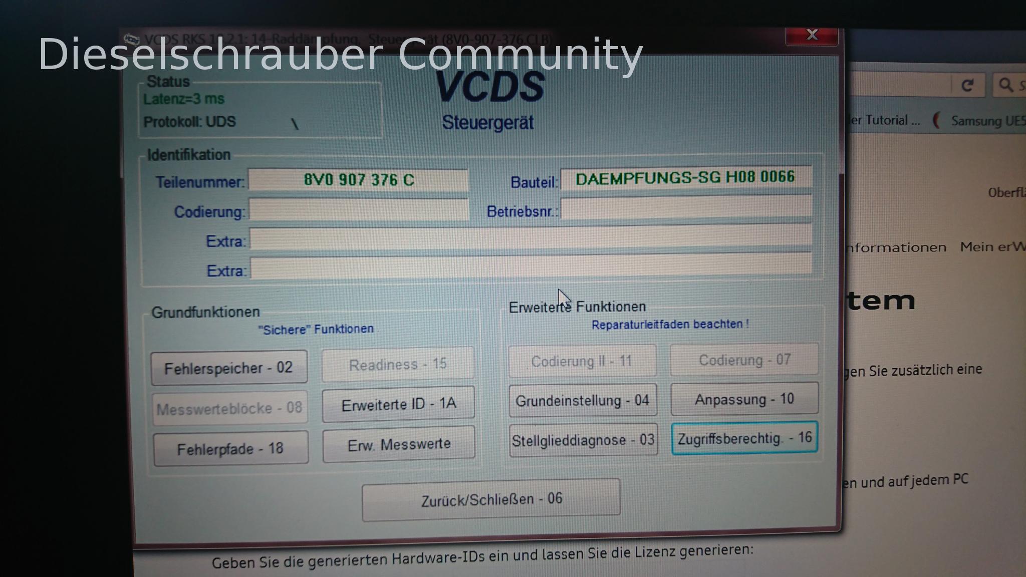

Post14-05-2018, 19:08    Subject: Access permission, radial dampening Quote
Here is the information about the control units.
Is there a way to access the labels again now?
Thank you very much.
Best regards, Mario.

Post14-05-2018, 19:29    Subject: Access permission, radial dampening Quote
Sure.

Posts: 18145
Karma: +808 / -0   Thank you, like it!
Post14-05-2018, 20:53    Subject: Access permission, radial dampening Quote
Yes, instead of the "Access Permission - 16" button, there are other options available depending on the specific control unit.
I found something, but I'm not sure if it's a good idea to post it publicly (for safety reasons), because an incorrect attitude can affect driving safety. icon_confused.gif
Therefore, please contact support at ross-tech.com directly in this case and explain what you intend to do.
Sure, you can refer to this topic as well.
