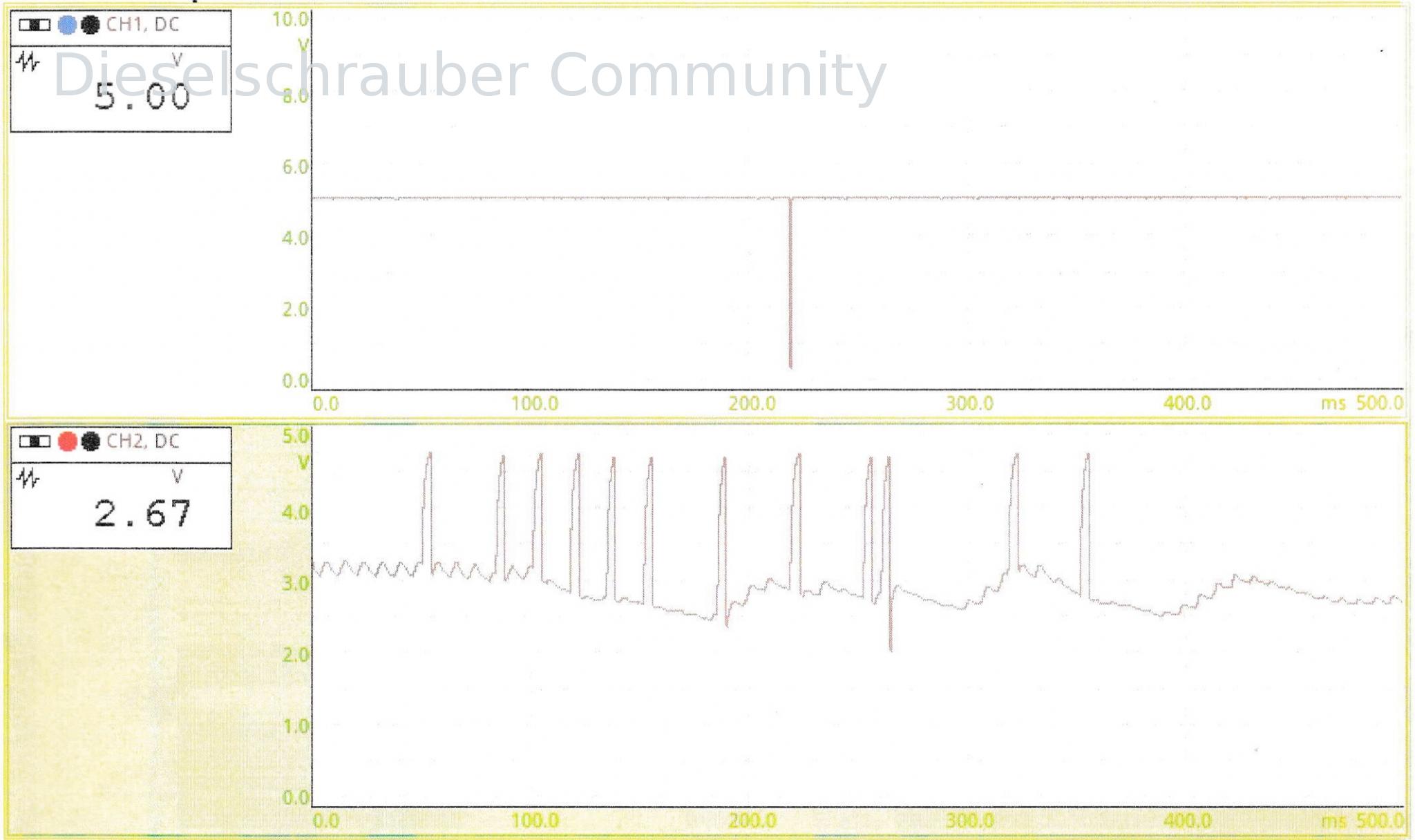

Replacing the G28 trigger module, the engine wiring harness, and the control unit did not improve the situation. Furthermore, I observe a drop in the 5-volt supply voltage when the error occurs, as seen on the oscilloscope. Due to the error, I also measured the rail pressure sensor. In the attached image, you can see the 5V supply voltage of the rail pressure sensor at the top and the signal at the bottom. It is noticeable that the rail pressure sensor signal has significant peaks upwards, then the 5V voltage collapses, which also disables the G28.

Post06-01-2020, 18:21    Subject: Caddy: Jerky Engine, G28 Sensor, Low Rail Pressure Quote
It looks suspiciously like it's been chewed on by a rodent or has had its cable insulation stripped.

"Yes, a chafed cable was also our initial suspicion, as all the +5V and ground lines of the affected sensor circuit are connected with solder connectors within the engine wiring harness from the factory, and we've heard reports that the wiring harness often chafes in the area under the battery. We haven't found any evidence of rodent damage or gnawing on other components either."
However, the fault persists even after replacing the engine wiring harness. Furthermore, checking the voltage at terminals 30, 15, and ground on the control unit using a different connector with a load applied showed no abnormalities, nor did testing for cable movement.
"It's strange that the rail pressure sensor is outputting these peaks directly at its output. My suspicion is that the +5V power supply is collapsing when these peaks occur frequently, and as a result, the G28 will immediately trigger an error."
Currently, we are still working on testing the fuel system. Unfortunately, we cannot obtain raw data readings from the rail without a rail pressure sensor connected to the engine control unit, as this is necessary to eliminate interference caused by wiring or the control unit. The engine is currently in a limp-home mode and does not display the error. Therefore, we are currently testing the fuel pressure at the inlet and outlet under various load conditions.

Post06-01-2020, 21:12    Subject: Caddy: Jerky Engine, G28 Sensor, Low Rail Pressure Quote
It's possible that the rail pressure sensor is internally defective, which could be causing this issue.
Can you temporarily use one from a different vehicle for testing purposes?

Post07-01-2020, 11:35    Subject: Caddy: Jerky Engine, G28 Sensor, Low Rail Pressure Quote
Good morning everyone.
Okay, so we've now installed a different rail pressure sensor. However, the error symptoms remain the same.
I was able to observe something unusual while measuring the fuel pressure.
Fuel pressure after the auxiliary fuel pump: approximately 4 bar.
Return pressure before the fuel filter: approximately 2 bar.
When the error occurs, the fuel pressure fluctuates by approximately 1 bar in both lines. Even when fueling the vehicle with an external pump connected to a canister, the same pressure anomaly is observed.
Surely, such pressure fluctuations cannot be of electrical origin and, for example, originate from the flow control valve of a high-pressure pump?
