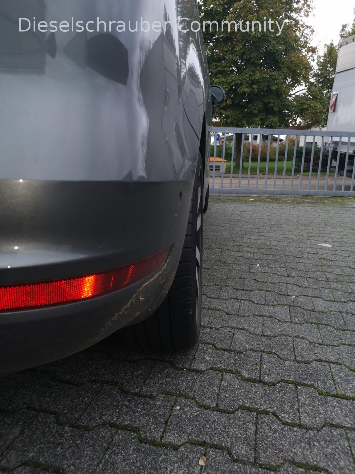

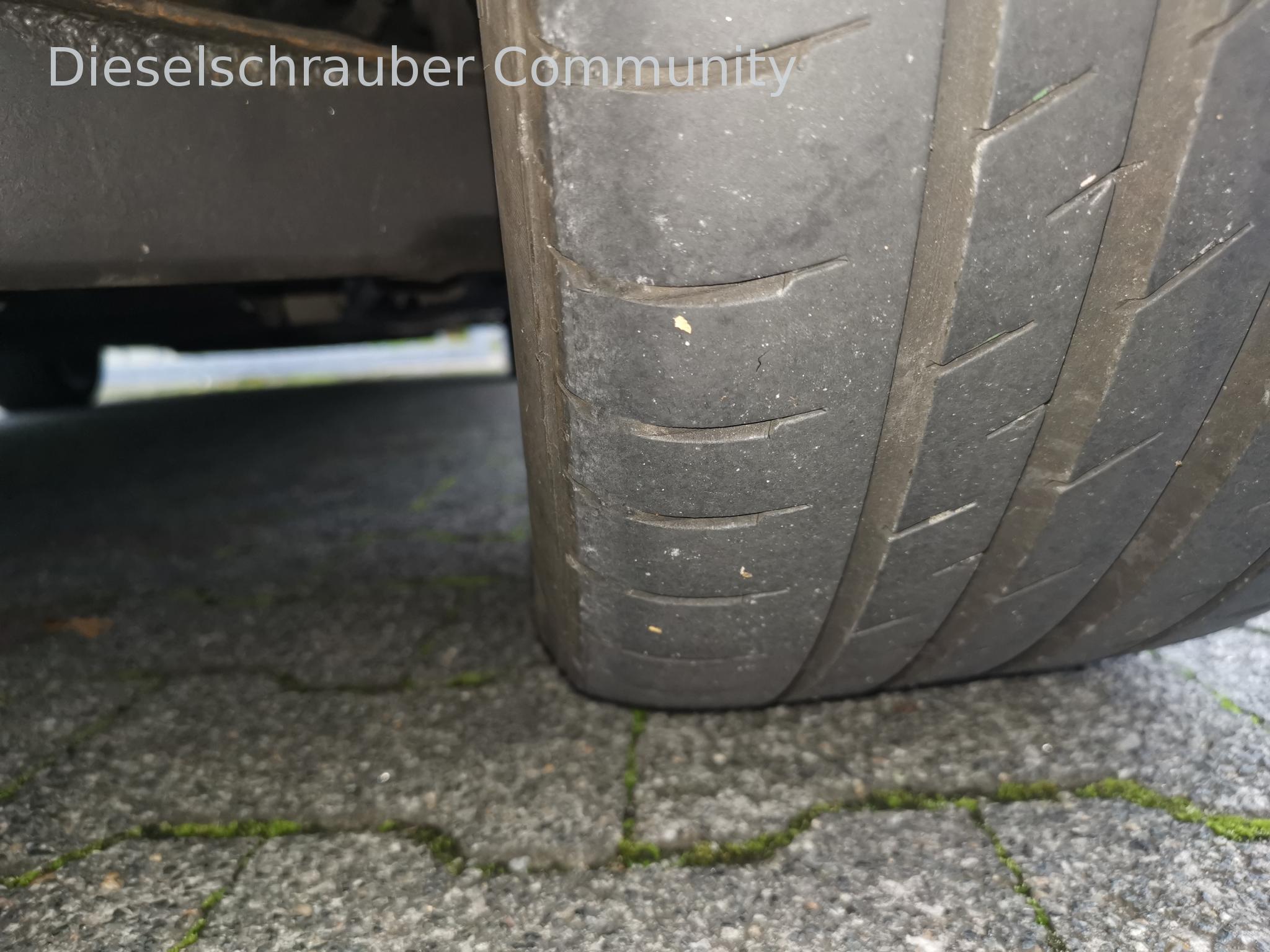

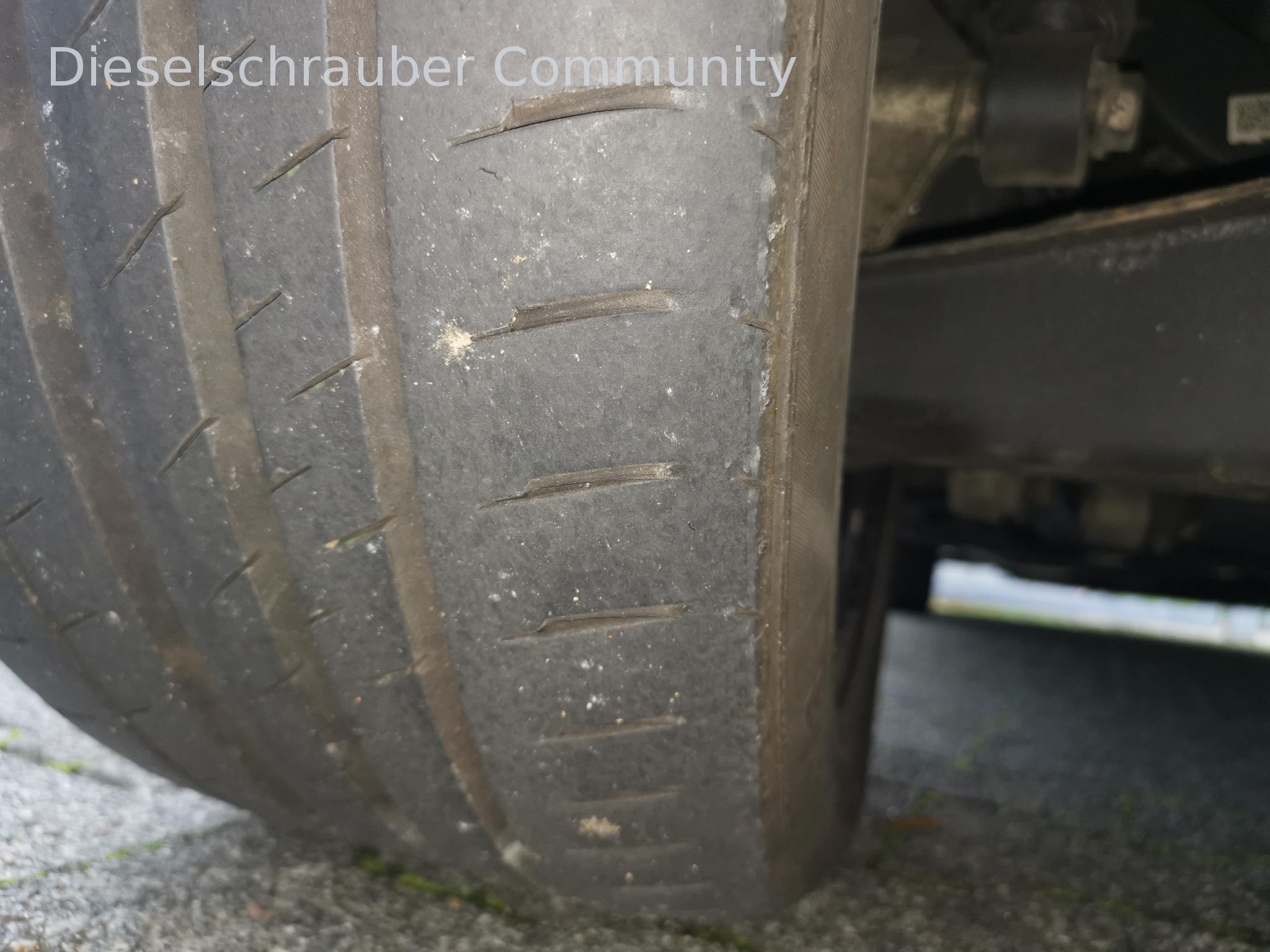

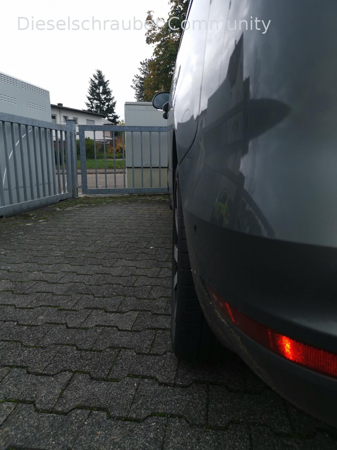

I have attached pictures from both sides. I don't think the rear wheels are particularly buckled.

Post21-10-2019, 18:39    Subject: Worn Inner Tire: Causes & Solutions Quote
Hi!
Based on the pictures, it appears there was a fairly significant and negative impact.
Also, it's symmetrical on both sides, if I take the bars of the gate as a reference point, and relatively even on both sides.
But I don't find the tire wear to be extreme.
And I also meant that you can adjust the suspension on the Sharan.
So: just measure it; there are often quite wide tolerance ranges.
You can also set or leave it at the tolerance limit.
