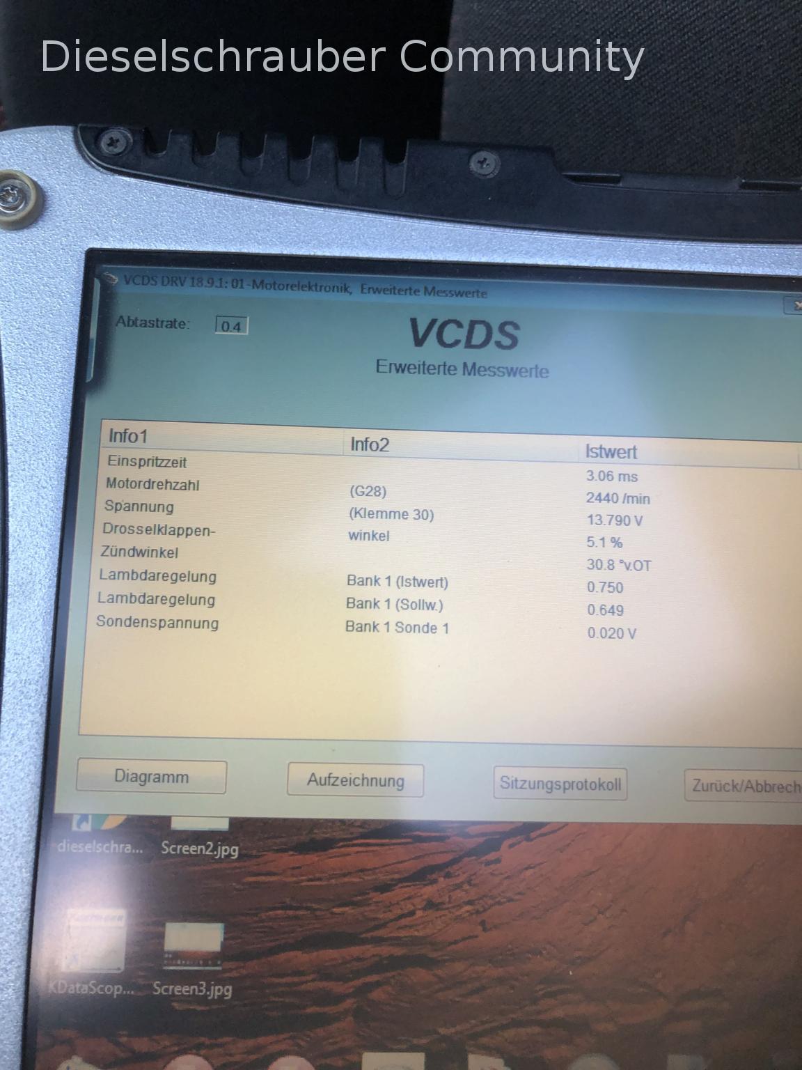

Post05-08-2019, 20:57    Subject: Problem with Lambda Control (Oxygen Sensor) on Seat Leon Cupra 1.8 T BAM Quote
Okay, so the Lambda values are off the charts, but the Lambda voltage of the control sensor is also far too low. It could be due to the low target and actual values, or am I mistaken?
The ignition timing is also very advanced; it's already at 35 degrees before top dead center (BTDC) at 2500 RPM.
Here's another photo attached. I can also upload the Autoscan file if needed.
Best regards,
Leon.

Post06-08-2019, 8:39    Subject: Problem with Lambda Control (Oxygen Sensor) on Seat Leon Cupra 1.8 T BAM Quote
What values do the sensors provide for the temperatures (engine, intake air, etc.)?
If the engine control unit (ECU) detects that it is too cold, it will enrich the fuel mixture and likely also advance the ignition timing.
That's one possibility.

Post17-03-2020, 11:17    Subject: Problem with Lambda Control (Oxygen Sensor) on Seat Leon Cupra 1.8 T BAM Quote
"Based on the numbers, you can already tell that it's performing extremely well." It makes your eyes water just standing near the exhaust fumes.
The premature ignition could be caused by the lack of boost pressure and the relatively low compression ratio, combined with an overly rich fuel mixture. Once it's warm, the knock control will adjust accordingly to prevent early ignition. In the current operating state, full early ignition can be applied. I wouldn't worry about this for now.
I'm assuming that the control system is excessively complex, and that the BAM (likely referring to a specific device or system) uses a 4-pole control probe. Typically, with these probes, you'll find the probe signal between pins 3 and 4. Usually, there are two cables of the same color and two cables of different colors connected to the probe, and you need to use the two cables of different colors. At Bosch, gray is for the positive probe (+) and black is for ground.
You should try measuring the voltage between pin 3 and pin 4 with a multimeter while the engine is warm. If the engine is running too rich, you should measure a voltage above 0.6V. If that's the case, you might have a wiring problem. If it's not, your sensor might be broken.
