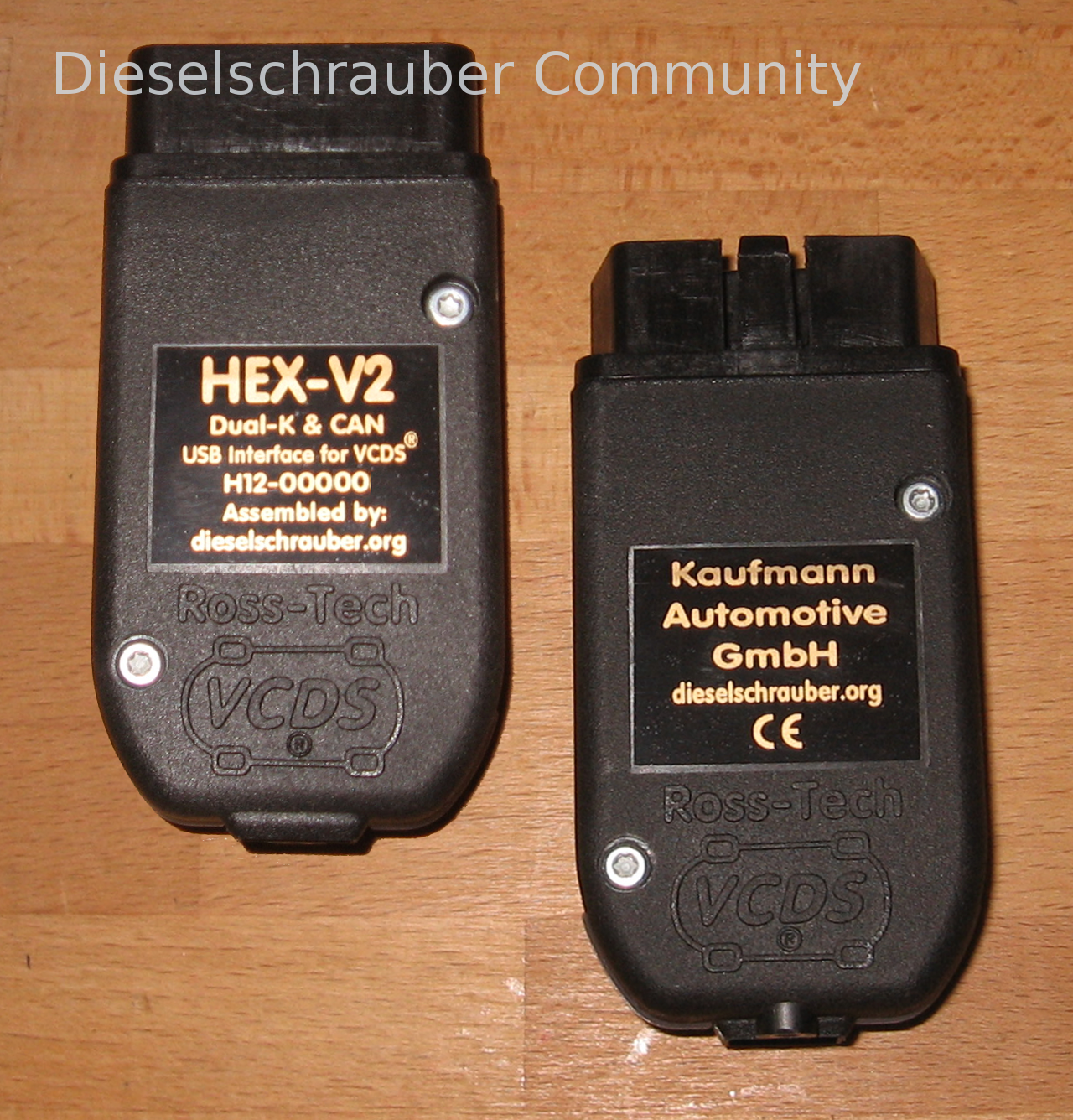

A new diagnostic cable, the HEX-V2, is now available for VCDS.
The HEX-V2 is required for vehicles from the 2018 model year and newer.
In VCDS, the following message will then appear: Please purchase a current Ross-Tech diagnostic interface.
It replaces the previous HEX-USB+CAN hardware. While the HEX-USB+CAN can be used with an unlimited number of vehicle identification numbers (VINs), the HEX-V2, like the HEX-NET, is available with different licensing options.
- For 3 vehicle identification numbers (VINs).
- For 10 vehicle identification numbers (VINs).
- Unlimited, workshop version.

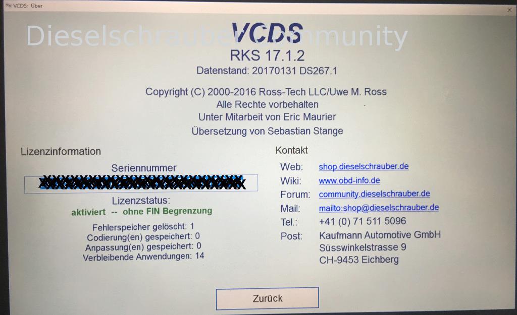

Hello, the new HEX-V2 arrived at my place today, super fast delivery.
I immediately read and cleared the error memory of the car, and then I saw the following...
Remaining applications: 14 (previously it was 15).
What does that mean?!

Hi Ben,
The counter "remaining uses" indicates how many times the HEX-V2 diagnostic interface (also applies to HEX-NET) can be used before it needs to be registered with Ross-Tech.
The corresponding tool (VCIConfig.exe) should automatically appear when the "remaining applications" count drops to 0. If you anticipate being offline later, you can configure it this way from the beginning.
1. Connect the HEX-V2 (or HEX-NET) interface to the computer with internet access and start the program VCIConfig.exe (located in C:\Ross-Tech\VCDS-DRV).
2. Open the registration tab in VCIConfig.exe, fill in the fields, and submit.
3. You will receive a code from Ross-Tech via email to complete the registration process.
I would have preferred it to be done like with the GS-911 Wifi... but okay, everything is in progress, and I'm sure something will still be changed. The registration process only needs to be completed once.
