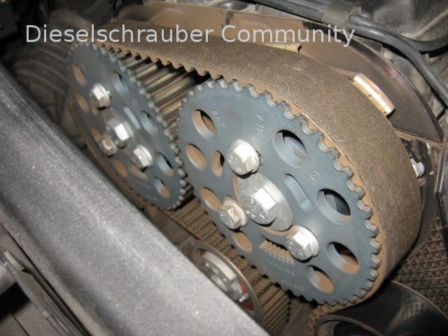

Post24-06-2020, 17:59    Subject: BMR Issues After PPD Switch Quote
phgraf wrote:
But I have one more question: Which adjustment screw? The manual doesn't mention anything about it, and I didn't have to loosen any screws when disassembling it.
Best regards,
Phillip Graf.
PS: Is it allowed to mention the name of the company
from which I got the working part? } As a tip for others who might be looking for a solution? }
The camshaft gears are rotatably attached to the camshaft and secured with 3 adjustment screws.
Yes.
 Verstellschrauben an den Rädern der Nockenwellen.
