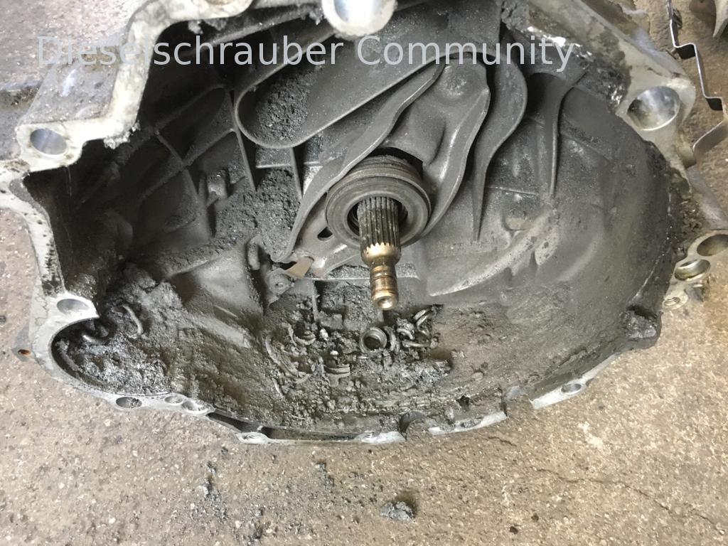

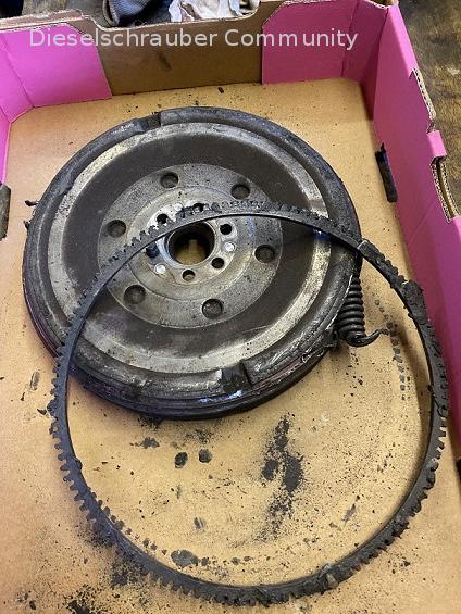

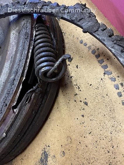

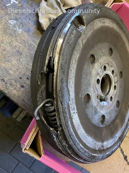

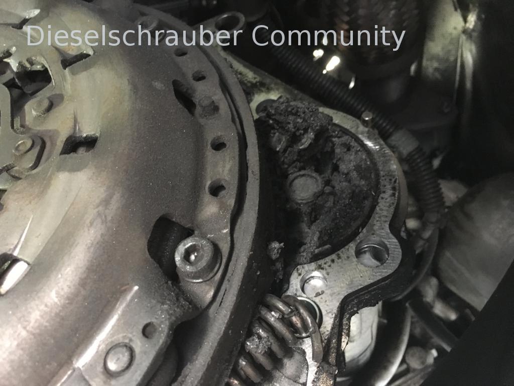

Last Monday, I unexpectedly broke down on my way to work. After 11 years of membership, I used the ADAC roadside assistance service for the first time. It worked perfectly. I can't fault it.
Here are some pictures of the dual-mass flywheel, which was the cause of the problem, for everyone's enjoyment.

Post06-07-2020, 16:59    Subject: Two-mass flywheel end of life Quote
238,000 km. There's not much to say about that.
It has already been repaired. The starter motor was also replaced.
He could have easily sparked with me. The feather probably created a nice shower of sparks inside the bell before it got stuck.
