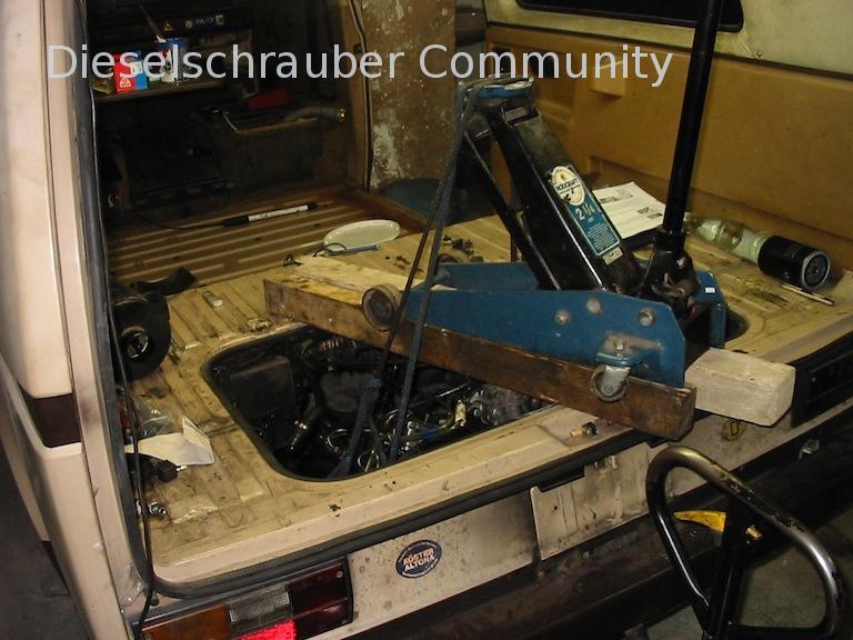

Alternatively: You can use sturdy wooden beams and lifting straps to lift the object, or place a jack on the beams and use a lifting strap attached to the jack.

It probably looks something like that; a tow rope would also work! The picture is from my T3 conversion project.
 Geht auch so nach TauBär´s Methode
