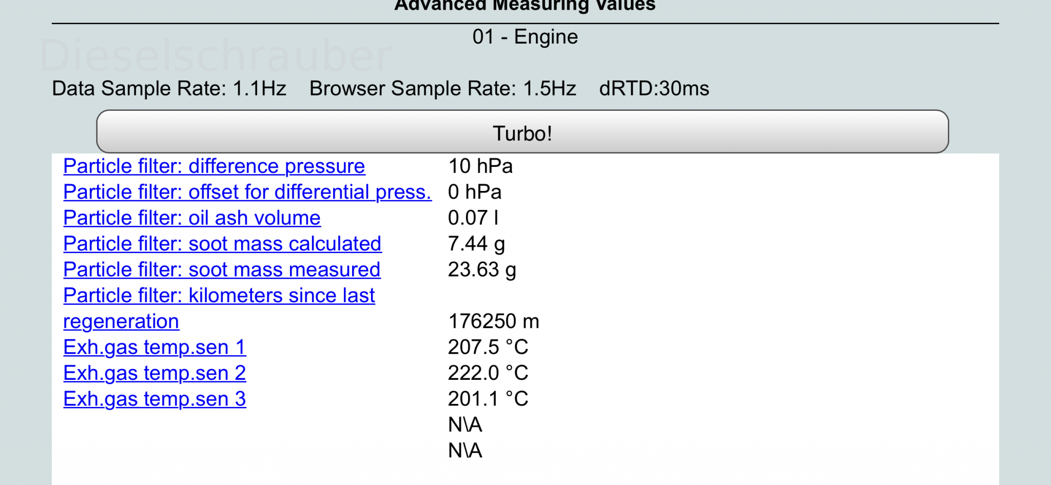

Hello from Vienna.
The filter in my 2012 Q7 4L 3.0L was flushed by a company that specializes in DPF cleaning.
A regular train journey was conducted.
*The differential pressure sensor was recalibrated (and the lines were also cleaned).
*then adjusted to 30,000 km (on the safe side, since it's not new).
So the question is:
The measured black carbon mass is very high, as shown in the image.
I've had some before, but never experienced this kind of problem!

 Vorher der spühlung

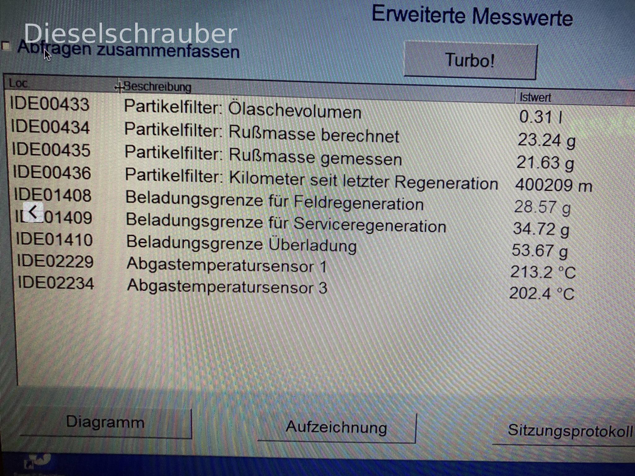

 Nach der spühlung

Post20-08-2021, 5:41    Subject: DPF soot mass measured as too high Quote
Okay, I don't really see anything seriously wrong here. The pressure is building up (both theoretically and practically, measured by the interpolated pressure drop, which is why there's an offset during the learning phase) until it regenerates. Since the regeneration, you seem to have driven approximately 400 km.
As soon as the next regeneration cycle begins, the coal will be burned to ash.

Post20-08-2021, 6:02    Subject: DPF soot mass measured as too high Quote
The measurement, which involved a 400 km driving distance since the last regeneration, was taken before the flush. I wouldn't have seen anything there either; even during the ash loading, there wasn't a reason to flush the DPF. icon_ntrs.gif 370 ml is the limit, isn't it?
The soot level in the second image seems a bit high, but it would be helpful to know if this is the first recording after a cleaning cycle, or if the system is now regenerating much more frequently. If so, the process continues with a recording of the differential pressure.

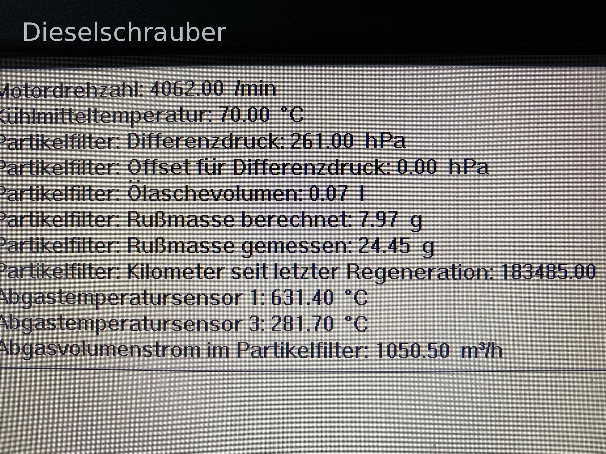

Post21-08-2021, 1:27    Subject: DPF soot mass measured as too high Quote
hi
Never touch a running system.
You're right, but I've had some issues with loading before, and then encountered problems.
Just for your information, here are the data and another log entry from today.
Is the differential pressure reading okay?

Posts: 18135
Post22-08-2021, 17:56    Subject: DPF soot mass measured as too high Quote
Yes, the differential pressure looks good.

Post23-08-2021, 5:42    Subject: DPF soot mass measured as too high Quote
The soot loading in the second image seems a bit noticeable, but we would need to know whether this is the first recording after the cleaning process, or whether regeneration is now happening much more frequently.
Is it being regenerated more often now? What were the testing conditions, and what were the air mass and boost pressure values during the differential pressure measurement?

Post23-08-2021, 5:57    Subject: DPF soot mass measured as too high Quote
There are also over 183,000 km since the last regeneration... perhaps there's some confusion. Drive until the next regeneration cycle, or initiate one manually and then observe the new cycle.
