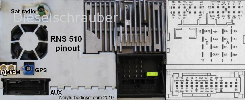

A question out of pure curiosity: What usually comes standard with the AUX port from the factory?
Actually, the signal from the TV was connected to one of the Kufatec devices.

Post12-08-2021, 20:34    Subject: RNS 510 Drains Battery: Troubleshooting Guide Quote
phgraf wrote:
A question on the side, purely out of curiosity: What normally comes standard from the factory connected to the AUX port?
Specifically, the signal from the TV was connected to one of the Kufatec devices.
It all looks easily flammable. If it were my car, I would sleep better after tidying up and securing things with duct tape. icon_wink.gif
AUX: I have no idea about that specific car. Generally, AUX is simply an input for external audio signals. In my wife's A3, there's a 3.5mm jack next to the handbrake for this purpose.
I used that input to add a Bluetooth audio connection.

Post14-08-2021, 11:09    Subject: RNS 510 Drains Battery: Troubleshooting Guide Quote
Yes, I've now completely removed everything; it was originally for DVB-T, which no longer exists.
The connection allows both video and audio to be input. I also have an AUX jack with a 3.5mm connector located under the armrest.
