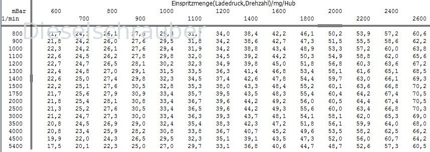

Here's a smoke map from CAGA, and it matches the measured values quite well.
 Audi CAGA: Engine Failure & Complete Breakdown

Post06-10-2021, 18:57    Subject: Audi CAGA: Engine Failure & Complete Breakdown Quote
Here is a smoke map from CAGA, and it matches the measured values quite well.
"You're right. Is that crankshaft from a standard engine? I wouldn't have expected that."
Once the engine starts running along the smoke curve, the turbocharger intercooler is likely to be clogged.
However, the question remains: why can't he achieve the desired boost pressure? Is the VTG (Variable Turbine Geometry) being properly adjusted when needed (e.g., during an actuator test?), and what is the differential pressure across the DPF (Diesel Particulate Filter)?
If nothing can exit from the back side, there will be no significant pressure difference across the turbine side of the turbocharger, and therefore no drive force.
