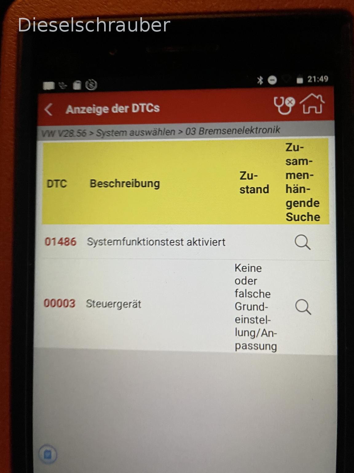

Post12-05-2023, 23:13    Subject: ABS control unit new, and coding always resets to 00 Quote
Evening everyone,
Today, I'm working on the launch again.
Everything's gone except for one mistake.
The encoding is now also saved.
He's still having trouble with the basic setup.
In the basic mode, 9 functions are displayed.
Do I have to go through all of them?
If so, is there a kind of guide on how to do that exactly?
Sure, please provide the text you would like me to translate from German to English. I will only provide the translation.

Post13-05-2023, 6:49    Subject: ABS control unit new, and coding always resets to 00 Quote
Sure, here's the translation:
"Addendum:"
Error 01486 is gone.
Didn't explicitly mention it above.
There is only error 0003 remaining.

Post19-05-2023, 8:58    Subject: ABS control unit new, and coding always resets to 00 Quote
Morning,
Okay, all errors removed.
The basic setting for the intake valve is...
The shut-off valves were not fully closed.
Everything is connected. Everything is okay now.
