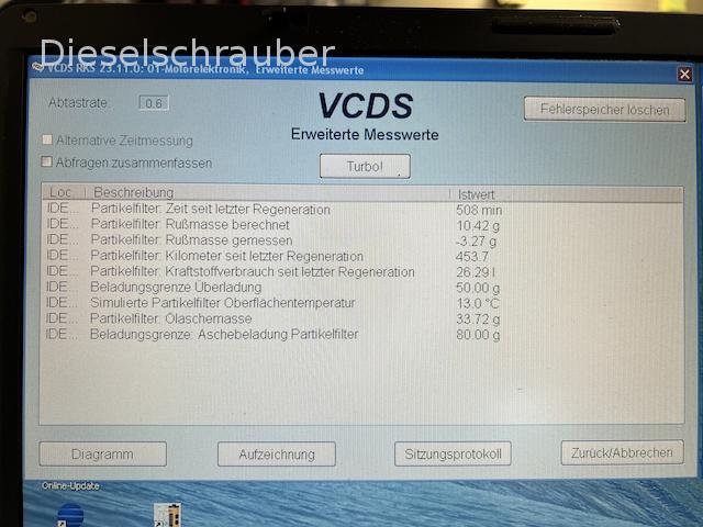

Hello everyone,
I would like to read the ash mass of the DPF in my Golf Sportsvan.
However, the button for the diagnostic data display is gray in the engine control unit.
Can anyone help me with that?
Thank you very much!

Post02-04-2024, 14:24    Subject: Read ash data Quote
This is a 2016 model year. There are no more measurement blocks available; only extended measurement data. You have to look there.
It's possible that the HEX+CAN interface is no longer fully functional for that model year, which is why you're seeing errors, and that's why I'm asking about the car scan.

Post02-04-2024, 14:49    Subject: Read ash data Quote
It's possible that the HEX+CAN interface is not fully functional for that model year, which is why there are errors, and that's why the question about the Autoscan.
Okay, you're welcome!
I have to admit that the LOG actually has nothing to do with my question; I just included it to provide the necessary data.
Okay, let's check the extended measurement data...

Post02-04-2024, 18:32    Subject: Read ash data Quote
Okay, it actually worked with the extended measurement blocks!
Thank you for the information!
