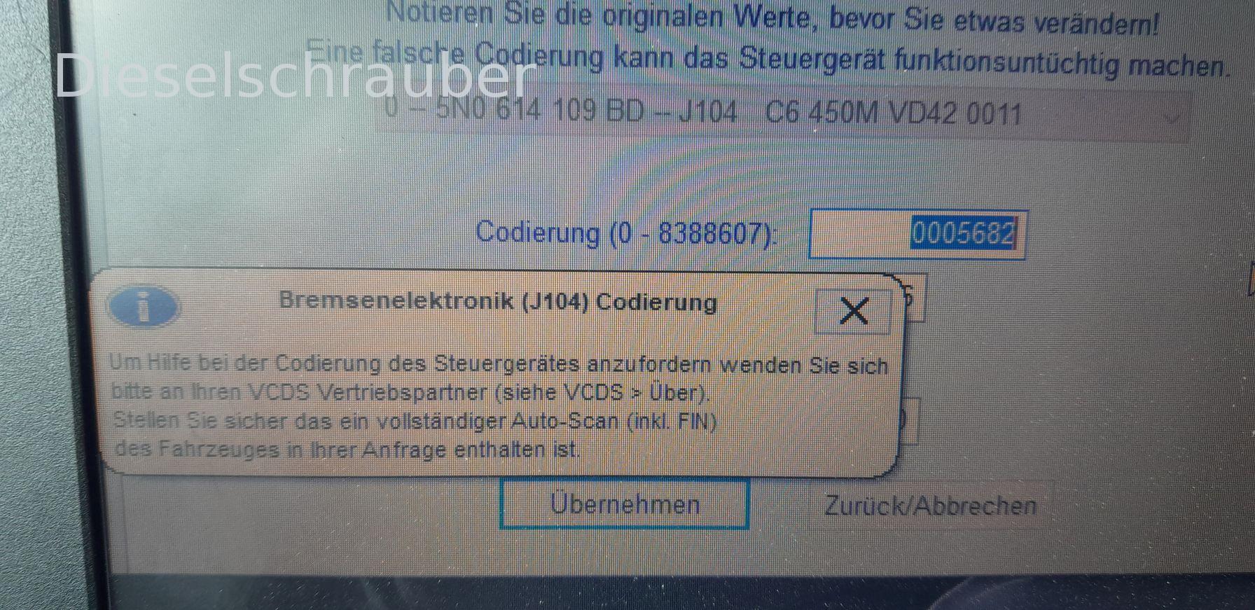

Post25-04-2024, 11:15    Subject: Cannot be translated Quote
Hello Rainer,
Unfortunately, nothing is appearing for me. Any other ideas?

Post25-04-2024, 18:36    Subject: Tiguan Coding: Error Code II-11 Fix Quote
Do you have the old/correct encoding? Where does the one shown in the Screenshot come from?
Did you read the message that you posted?
Translated on 29-07-2026, 7:55.

Post25-04-2024, 18:57    Subject: Tiguan Coding: Error Code II-11 Fix Quote
Okay, I've been working exclusively with Mercedes vehicles for about 30 years, and I think I know pretty much everything about them. But when it comes to Volkswagen, I'm completely clueless. X
My employee found something online, but it doesn't work. I can't use that, and I don't understand that message. I usually only work with Mercedes software, but my ex drives a VW, and unfortunately, I can't say no;-)
