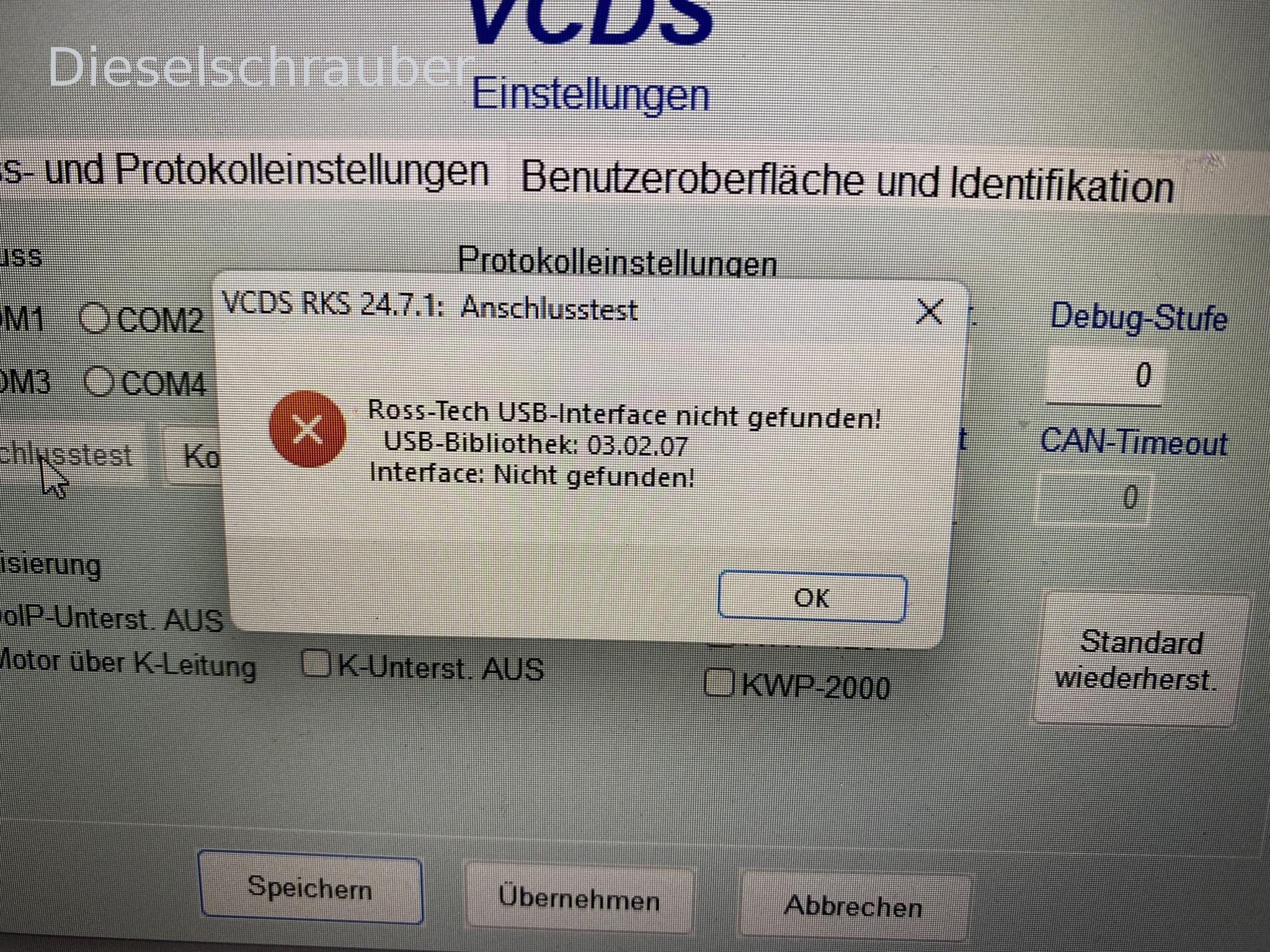

Hello forum, my VCDS is not starting anymore. See photos.
I would be very grateful for any help. Wolfgang.

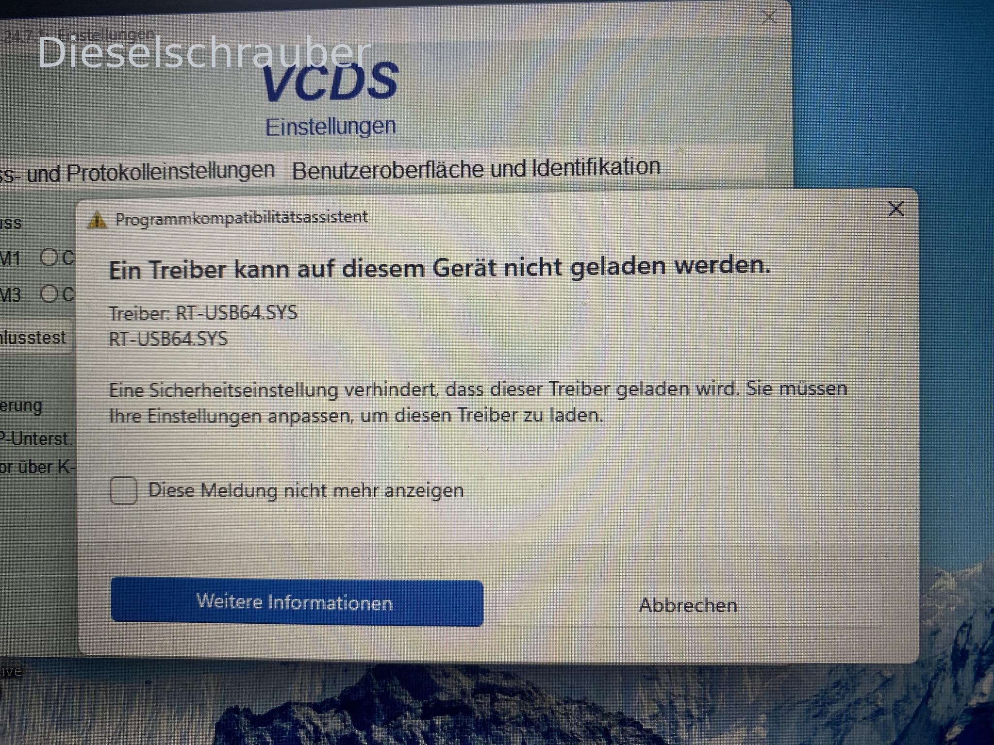

Click on "More Information"?

Hi Rainer, I clicked on "more information" and restarted my computer, but it's still not working. Greetings, Wolfgang.

Yes, and what is displayed under "More Information"? The computer clearly states that it cannot load the driver because a specific setting is preventing it.

Post19-11-2024, 21:57    Subject: Ross-Tech USB interface not found! Quote
Everything is back to normal. I deleted the driver.
VCDS is operational again. Thank you for your help.
Best regards, Wolfgang.

Well, maybe someone else has had the same problem and would be willing to explain what the issue was.
Possibly a driver for amd64 on an ARM system...

Post20-11-2024, 11:32    Subject: Ross-Tech USB interface not found! Quote
Hello Rainer,
I started an HP update, and after 20 minutes, the problems were resolved.
Thank you for your help. Wolfgang.

Schmierpfote wrote:
Hello Rainer,
Okay, so something changed in Windows, and then it started working.
Okay, I understand.

The problem is likely due to a security update for Windows 11. I don't know if Windows 10 also received that security update.
It's related to the core isolation feature, which can be disabled in the Windows settings under "Privacy and Security" -> "Device Security".

Hello Turbinchen,
I have Windows 11, and that was the reason for the problems.
