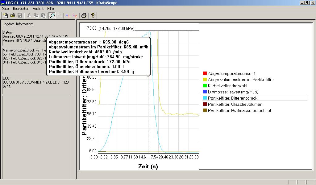

Post08-05-2011, 11:29    Subject: DPF Back Pressure Normal Values Quote
Audi A3 8PA 2.0 CR TDI 103kW
Engine code CBAB
Series
14.000km
Ambient Pressure 950mbar
Intake Air Temperature 21°C
See the difference log as presented by KDataScope.
 CBAB Differenzdruck mit KDataScope
 File size:  97.46 KB
 Viewed:  121056 times
