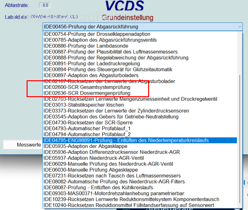

Hello everyone,
I would like to start the aforementioned test with a warm engine (approximately 90°C), but I receive the message "Running..." and then, after about 5-10 minutes, the test is aborted due to a timeout.
It seems like the routine is waiting for some prerequisites or conditions and then aborting.
Are there any instructions or guidelines on how these routines should be carried out?
This also applies to IDE02636-SCR dosage quantity verification.
I would appreciate any advice, as the forum unfortunately doesn't provide instructions on how to perform the tests, either when searching for "Caddy SCR" or for the IDE numbers.
Thank you.

It is probably due to:
Address 01: Engine Control Module (J623-DFSD) Label file: .DRV\04L-907-309-V1.clb
Part number SW: 04L 906 016 MQ, HW: 04L 907 309 K.
Component: R4 2.0l TDI, H20, 4100.
Revision: 8AH20--- CVN: 7CF28D74B866C2AD
Encoding: 0111003204340D090000
Operating number: WSC 35110 790 50316
ASAM Dataset: EV_ECM20TDI01104L906016MQ 001001
ROD: EV_ECM20TDI01104L906016MP.rod
VCID: 04508BE1AE966FCAAB2-8050
VINID: 9E60AAAAA09BA9AA001070451820FF63D9
"One error found:"
22585 - Sensor for reducing agent level.
P203B 00 [01100101] - Implausible signal
unconfirmed - checked since last deletion
