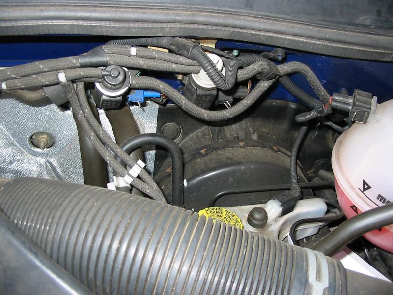

Gremlin
Guest
Post08-11-2003, 23:19    Subject: Glue Stick Heater ASV Quote
Could it be that the candles are not included in the NL version of the ASV?
Yes, that's definitely possible.
I've seen two Octavia models (presumably from the Netherlands) that didn't have glow plugs.
It's best to take a look; you can usually see the strut without having to remove the engine cover.
See the picture; this is what the sock looks like without the heating element.
CU Gremlin.

Jan6K
Avatar-Jan6K
Posts: 4741
Location: Hagen
Post09-11-2003, 0:01    Subject: ASV Glow Wire Heater Quote
Hi Gremlin,
Thank you for your reply and the picture. I'll see if I can find something similar without having to disassemble anything (the 6K model has a completely enclosed front). Otherwise, I'll do it when I install the LDA sensors.
Hopefully, I can find some – I've actually integrated some nice LEDs specifically for that purpose into the LDA technology. Well... if not, I can always use them for something else... or I can connect the pre-glow to all three instead of just one, as planned.
I'm surprised that the actuator diagnosis shows the heating system is active, and that there are no negative error messages.
Does anyone know what happens when an actuator is missing or malfunctioning during actuator diagnostics? Does it trigger an error, or is the purpose only to allow manual observation (using a multimeter, etc.) of how the EDC controls the actuators, without the system actually monitoring them?

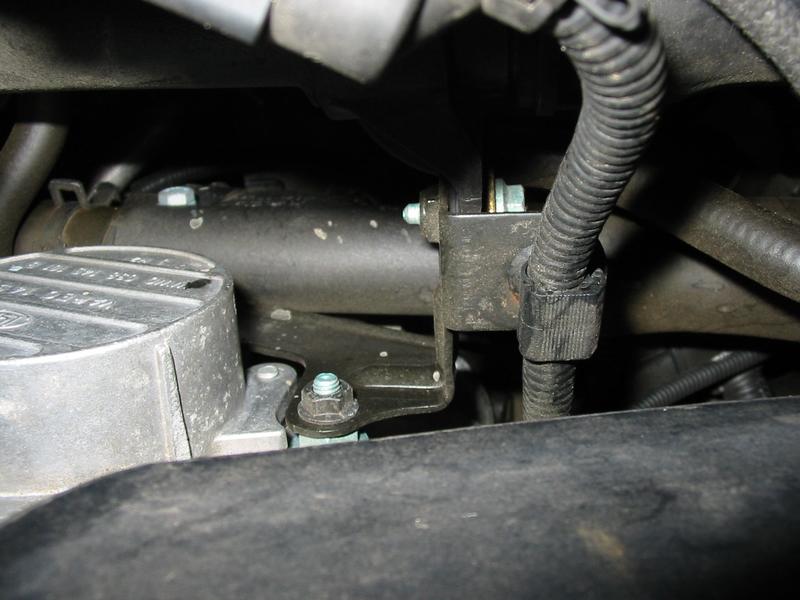

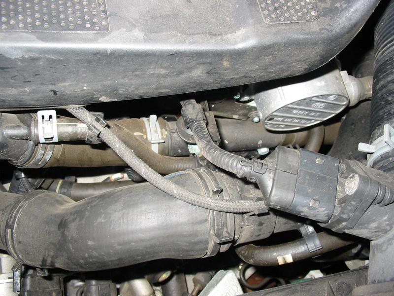

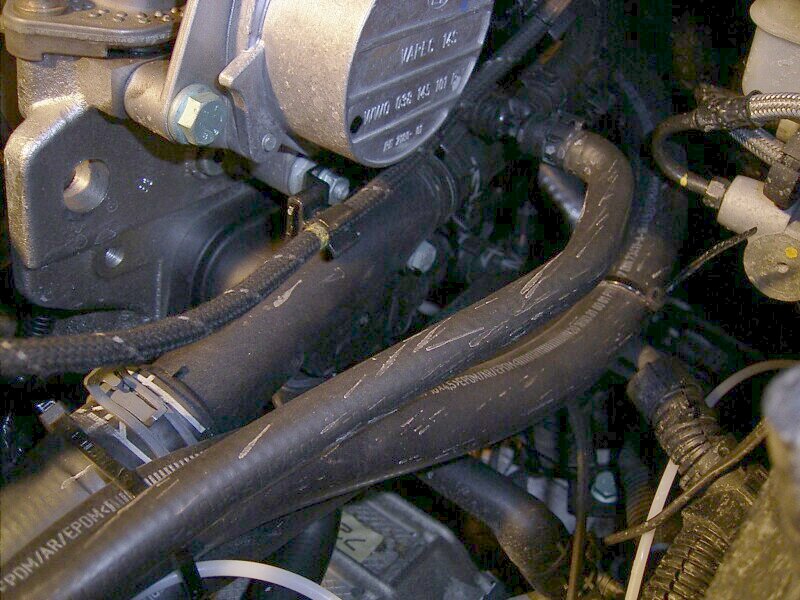

Jan6K
Avatar-Jan6K
Posts: 4741
Location: Hagen
Post09-11-2003, 12:38    Subject: ASV Glow Wire Heater Quote
Hello Ulf, hello Gremlin,
Thank you for your replies... it seems that my car does not actually have a GSH (presumably referring to a specific component). I just went down to check, but unfortunately, I couldn't remove the engine cover because I have my socket set at work. However, it does appear that it's not there.
I took a few pictures just to be sure, but to me, it looks very clearly like the part from the Gremlins image. You can take a look and see what you think... I can clearly see the flange piece from the Gremlins image instead of the differently shaped piece with the GSH marking.
What surprises me even more is that my car actually has very few problems warming up properly in the winter. While it takes about 15 to 20 km to reach the 90-degree water temperature in very cold temperatures, I haven't experienced any issues with the temperature not staying at 90 degrees, not even in gentle city driving where the engine speed rarely exceeds 1400 rpm and the average fuel consumption is only 5.4 liters. Could it be that the very tightly packed engine compartment plays a role, keeping the heat where it is needed?
Best regards,
Jan.
Edit: I've added the third picture... I was too hasty when I submitted.
 Nochmal aus einer anderen Perspektive
 File size:  59.91 KB
 Viewed:  1409 times
 Ganz unten ist das Rohr von Gremlins Bild... oder?
 File size:  92.41 KB
 Viewed:  1412 times
 Da sollte das Relais sitzen, nicht wahr?
 File size:  93.52 KB
 Viewed:  1438 times
1Z5 CFHF / AHB H4D
Translated on 16-09-2026, 18:40.
Joined: 04/13/2002
Posts: 11058
Location: Saarland
Post09-11-2003, 12:55    Subject: ASV Glow Wire Heater Quote
Jan6K wrote:
It seems that my car does NOT have GSH.
Yes, I just checked our ALH again:
The three spark plug connectors are located right next to the vacuum pump, standing upright like a punk hairstyle. They are very noticeable.
There's nothing like that with you -> so no GSH.
Translated on 16-09-2026, 18:41.
