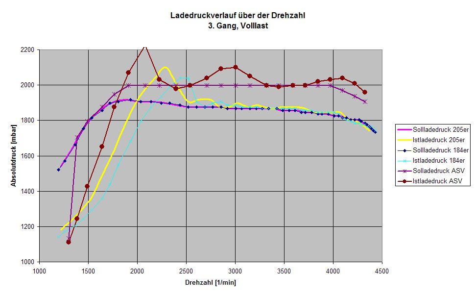

@Jan6KViewing profile: Jan6K:
I was quite surprised to see that the boost pressure setpoints of the ASV are about 100-150 mbar higher than those of the AGR in the mid-speed range. I thought there would be no difference. Perhaps the boost pressure was slightly increased in the ASV compared to the AHF, due to the stricter emission standard (Euro3 for the ASV instead of Euro2 for the AHF), in order to reduce particulate emissions.
Can anyone confirm or deny this? Does anyone perhaps have AHF logging data (Rainer?), to shed light on this matter?
In the attached diagram, I have overlaid the characteristic curves. It is clearly visible that the setpoint values are identical up to approximately 1800 RPM; above that, the aforementioned difference in boost pressure of about 100-150 mbar arises in the setpoint value.
It's also very clear that the VTG turbocharger responds much faster and therefore builds up boost pressure more quickly.
It's important to compare it to an engine with stock injectors that hasn't been modified, because the difference is really significant in that case. Also, you can clearly see that the target boost pressure isn't reached until much later.
Regards,
Alex.

If my memory serves me correctly, the AFN (and presumably also the AHF) activates at 2000 mbar, just like the ASV does. Or am I mistaken?
By the way, the diagram is a really interesting comparison between VTG and wastegate.

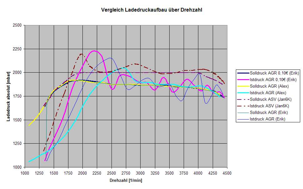

Hello everyone!
After a long time and with the kind support of some forum members icon_biggrin.gif, I would like to take this opportunity again to present the data collected so far in a (somewhat cluttered) graphic.
Here's the translation:
"You can see a direct comparison between my EGR system with its slow boost pressure build-up, the "normal" boost pressure build-up of an EGR system, the behavior of an EGR system with a 10-cent tuning modification, and in contrast, an ASV engine."
All the Wires were logged during a Differential Zero-Crossing (DZR) test at the same level on the 3rd floor, so they are directly comparable.
I find it remarkable that the pressure increase of the wastegate turbocharger is no less than that of the VTG turbocharger (when the same exhaust mass flow rate is enforced -> a "10-cent" tuning). However, the VTG turbocharger can already produce higher boost pressure at lower engine speeds. This is very clearly visible.
To complete the overall picture, we still need DZR (Data Zone Recorder) logs from both the AHF (presumably a specific engine type) and the ALH (another engine type). Then, we would have the ultimate comparison with an identical mechanical engine platform.
Another (bitter) realization for me is that I definitely have a problem.
I have now made suitable sealing plugs for the charge pressure hoses on the intake manifold and at the compressor outlet. One of the plugs has a tire valve and a pressure gauge connection. I still hope that with these tools, I will be able to find a leak. It would really be unfortunate if it turns out to be due to the turbocharger icon_confused.gif.
Keep your fingers crossed for me!
Oh, I'm still happy to receive any posted log file for the engine codes that are still missing icon_biggrin.gif.
