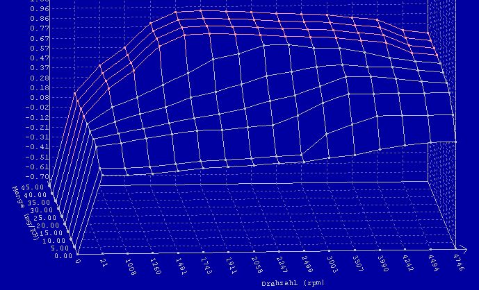

Post03-06-2004, 8:41    Subject: Meaning of the Air Mass Standard Value? Quote
The boost pressure is being reduced.
Here's a KF from a 1Z
Greetings
 File size:  83.04 KB
 Viewed:  2366 times
joergs
Guest
Post03-06-2004, 9:16    Subject: Meaning of the Air Mass Standard Value? Quote
so, that should explain the intrusion of air mass.
as I see it, the reduction in loading pressure for the PDs is also greater than that for the VEPs. This probably also contributes to the sluggishness in the upper speed range...
