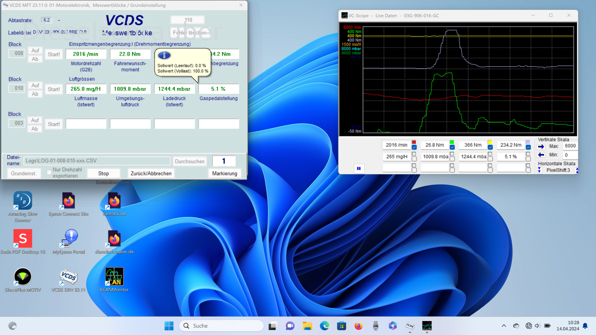

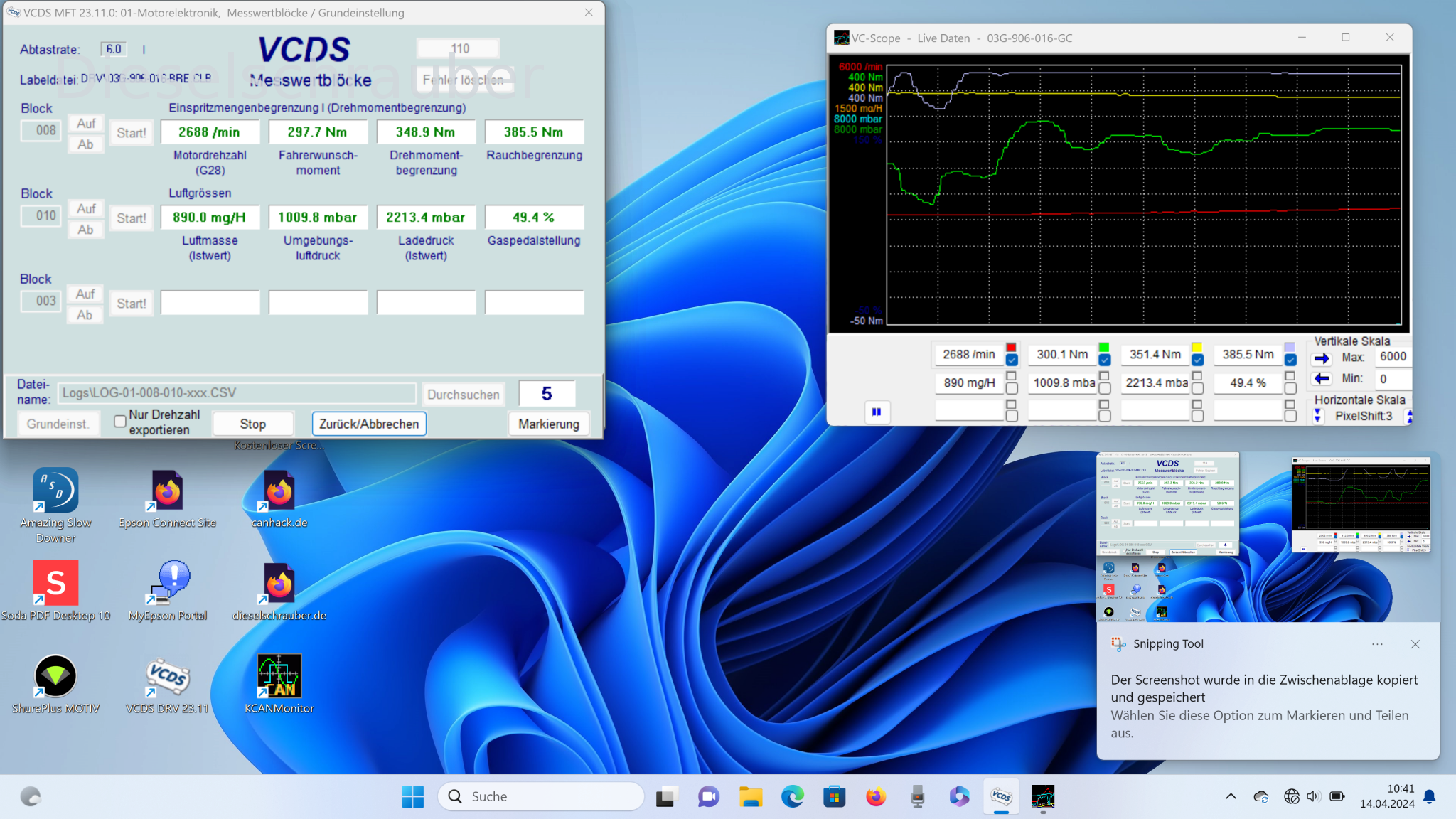

Post15-04-2024, 17:17    Subject: Troubleshooting Log Files with MWB 080 and 010 Errors, with Screenshots Quote
I tried to analyze the log file LOG-001-080-010-xx_140424, but unfortunately, it wasn't possible to use full throttle during the trip, which likely made the analysis more difficult.
Despite everything, during the journey, "fortunately," the yellow engine warning light came on – and, as far as I remember, it came on repeatedly – when driving at higher speeds on the highway.
That's why I created a chart in Excel, starting from the approximate time of the highway trip, as part of my attempt to analyze the data.
It is important to note that when the light illuminated, there was no noticeable "camel jockey" effect.
And the error memory reading, which pointed to a time three days before the test drive, also showed no signs of "camel jockey" behavior. The error memory indicates, as before, an implausible signal from the mass airflow sensor.
If my data is not yet suitable for analysis, please let me know.
The PNG files of the screenshots reveal that, unfortunately, the line for the second MWB (010) was not selected.
However, everything was written correctly in the CSV file.

Post15-04-2024, 18:20    Subject: Wave-like acceleration at medium speed, MKB BRE Quote
The images are useless. Just check if the torque limit of the transmission is the lowest limit when accelerating at full throttle.
I actually thought I had already written that.
And if the mass airflow sensor (MAF) is showing an error code, then just post it. What else?
Translated on 07-07-2026, 4:01.

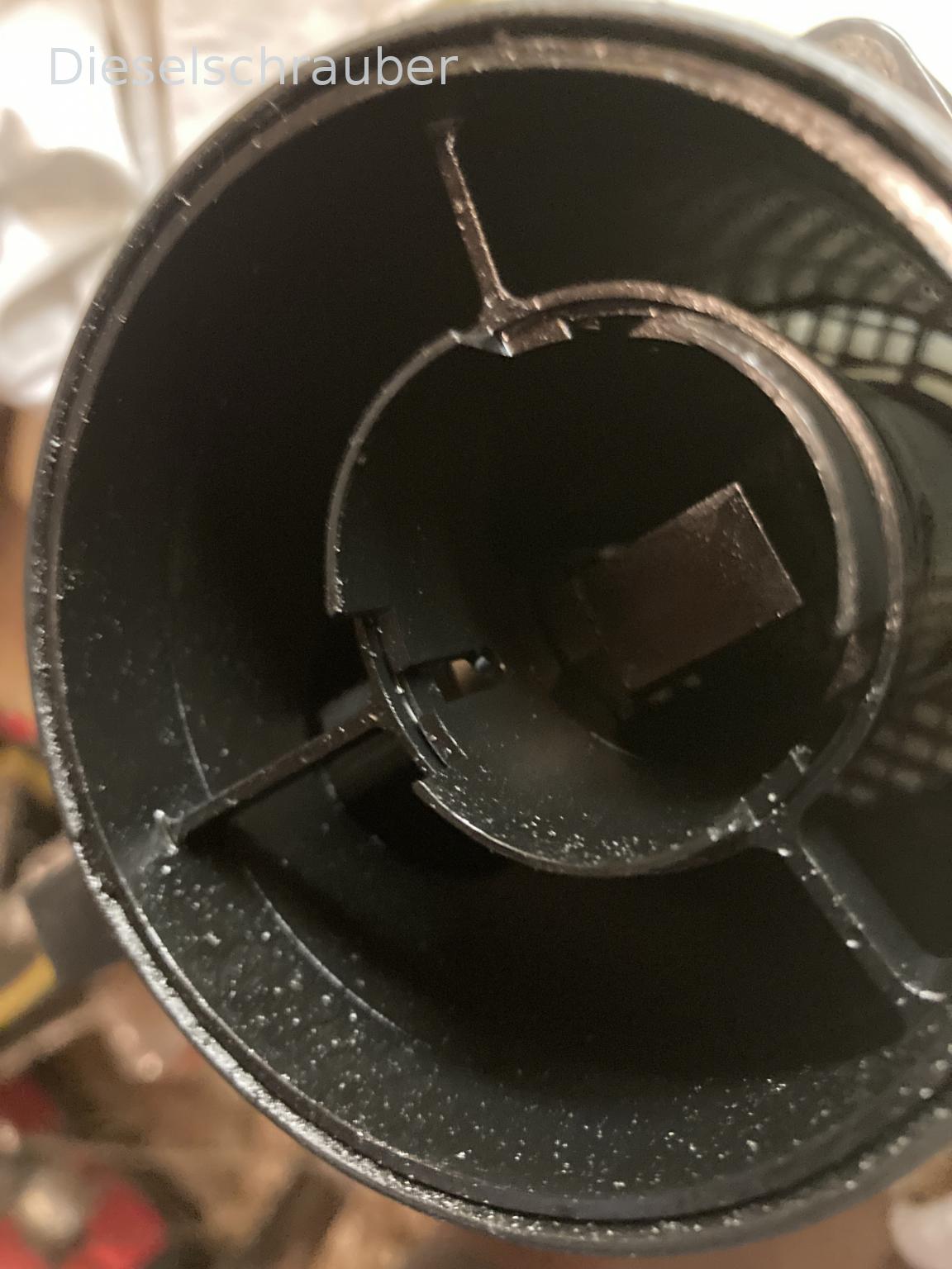

Thank you for the answer.
I have now installed a Bosch mass airflow sensor that is compatible with or contains the components of the original Bosch sensor, part number G70.
The wave-like acceleration is currently no longer noticeable.
Since I mostly drive short distances in my car, I cleaned the EGR valve and the throttle body about 8 weeks ago. Four weeks ago, I removed the intake manifold because, after removing the EGR valve, I found a significant amount of oily residue there and wanted to see how far the buildup extended.
Fortunately, there wasn't much left to clean on the engine side. However, the EGR valve looked quite bad. I can provide a picture if needed.
Last week, I inspected the boost pressure hose connected to the turbo. It was oily on the outside, but thankfully almost dry on the inside. (I can provide a picture if needed).
Now that I've just installed the new LMM, I'd like to know what you think about the oil film on the old sensor. See image.
Is the oil coming from a faulty crankcase, or in which direction should I continue my investigation?
Thank you for your support.
Best regards,
Ronald.
