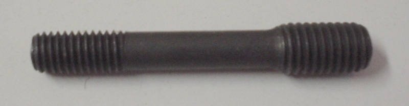

Post02-03-2005, 22:52    Subject: Timing Belt Replacement: Bolts Too? Quote
For the record, here's the bolt I'm referring to:
On the left, the tensioner is attached, and on the right, the motor icon_smile.gif.
 File size:  73.51 KB
 Viewed:  1891 times
Translated on 26-08-2026, 15:45.
Roadagain
Guest
Post02-03-2005, 23:20    Subject: Timing Belt Replacement: Bolts Too? Quote
I would make the decision very simply. If the bolt comes out using the lock nut method, then definitely replace it.
If you determine that the object is securely in place, leave it there.
Greetings.
Translated on 26-08-2026, 15:46.
Joined: 03/13/2003
Posts: 10121
Location: in der Werkstatt
Post02-03-2005, 23:27    Subject: Timing Belt Replacement: Bolts Too? Quote
Haha :/
That's not so simple.
We broke all the "high-strength" screws from Kruemmer that attach to the turbo on every T3 we had.
You just keep tightening, and eventually, something moves... that's the plastic phase before the break icon_sad.gif.
And if I've already tightened the bolt, then it *must* come out.
So, it's either "let them stay inside" or "definitely take them outside."
