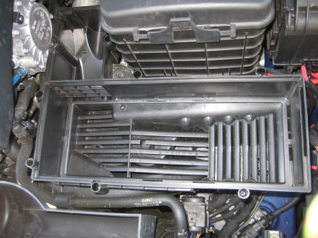

Post06-08-2007, 9:42    Subject: Air filter housing - a science in itself Quote
Here's a photo of the distribution manifold BEFORE the filter in the 3C.

Post06-08-2007, 10:09    Subject: Air filter housing - a science in itself Quote
Hm,
Can you please elaborate on that with a few more sentences? Does the air come from the top? And where does it go? This grid on the upper left is open and leads into the engine compartment, towards the battery? You're welcome.

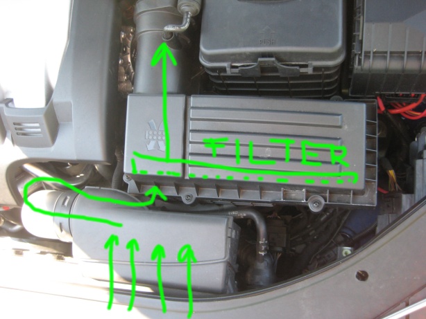

Post06-08-2007, 10:48    Subject: Air filter housing - a science in itself Quote
Sure, here's the translation:
"Here is the whole thing, written in a very verbose and elaborate style."
The airflow comes from (in the image, from the bottom) the front and goes into the engine compartment.
In the first chamber, a portion of the air is "skimmed off," while the rest exits through the back and bounces off the air-fuel ratio sensor. Here, water droplets sometimes pass straight through and are thus filtered out.
Then a large, curved section goes downwards and connects to the air filter housing at the bottom.
Then we'll go upstairs to the LMM.
The pipe leading to the mass airflow sensor initially connects to a box that also has something to do with air, but I don't understand why a dead space was created on the dirty side – perhaps to reduce noise.

Post06-08-2007, 11:31    Subject: Air filter housing - a science in itself Quote
Aha! Okay, now it's becoming clearer. And the filter sits horizontally on this grid, as you can see in the first picture, right? Hmm, it looks nice! Not much water will reach (and pass through) the filter.
