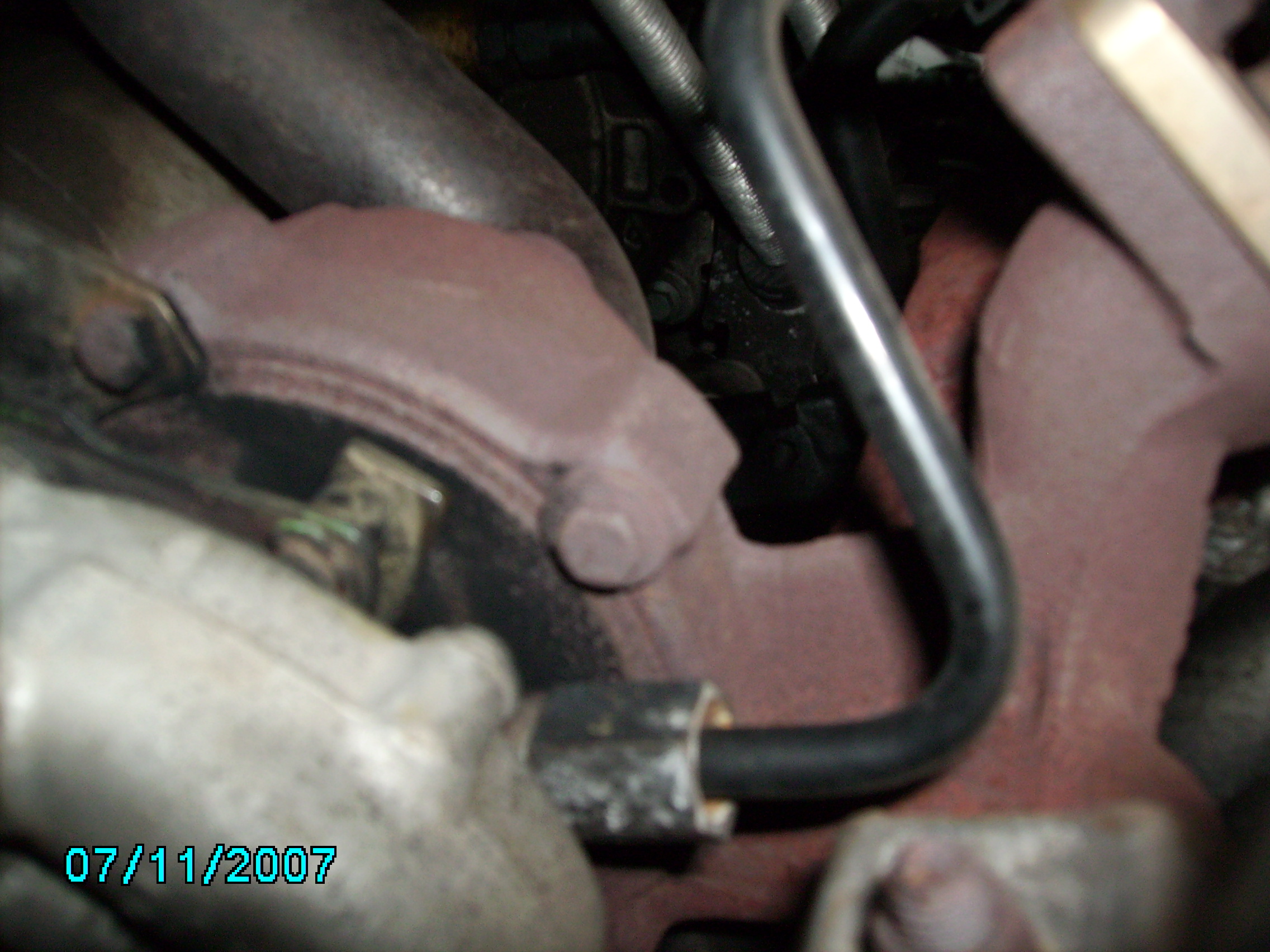

I took out my camera and tried to get some pictures. I'm starting to doubt everything. Can someone tell me if the fuel tank cap is installed correctly? The larger arrow points towards the rear of the car, while the smaller arrow probably indicates the direction of flow towards the engine. Could the hoses be reversed? Anything is possible, as I said, I'm doubting everything I've put together on this car so far; sometimes you can end up "fixing" something by breaking it further.
What is the expert opinion on the Russ turbocharger?
1. normal
2. Reference to damage or harm.
3. Tolerable because it may be caused by a sudden drop in boost pressure?
Who has experience with this?
Thank you in advance to everyone.

Hello Bernd,
If I interpret the photo of the loader correctly, I would say there is a leak icon_confused.gif.
I recently replaced my charger - it's a VTG unit - and I couldn't find any soot on the exterior of the casing.
Best regards,
Wolfgang.

Yes. It appears there's a leak coming from the VTG adjustment mechanism.
Could it be that the VTG (Variable Transmission Gear) gets stuck in the "open" position?
After that, the car would likely enter a limp mode because there would be little or no boost pressure, or it would build up too late.
My EGR valve went into limp mode due to a leak in the charge air system and the resulting lack of boost pressure, but without the glow plug indicator light illuminating.
However, there should then be an error message displayed.
No, I don't think it's likely related to the leak in the VTG adjustment system.
What do you think?
