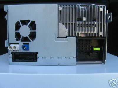

Post27-11-2007, 14:50    Subject: RNS510 Wiring Diagram: Find Yours Now! Quote
Hi.
I can only provide a picture from the back.
The connector on the right appears to be identical to the one on the RCD500.
The one on the left, located below the three antennas, is an additional unit to the RCD500.
 File size:  17.34 KB
 Viewed:  10359 times
Translated on 13-09-2026, 15:36.

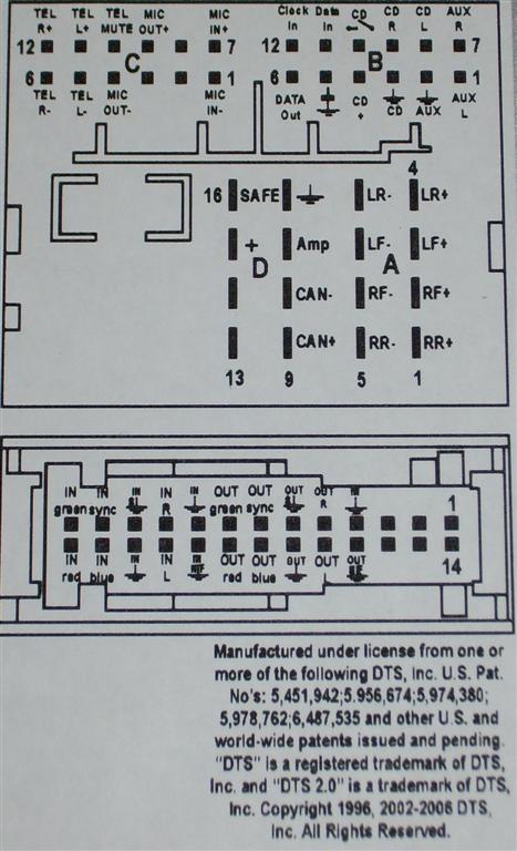

Post07-12-2007, 15:39    Subject: RNS510 Wiring Diagram: Find Yours Now! Quote
I found something else.
 File size:  61.12 KB
 Viewed:  13858 times
