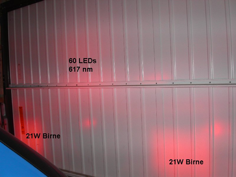

Post23-12-2007, 8:37    Subject: Quote
oldewurtel wrote:
No, red ones - to allow as much of the emitted light as possible to escape outwards, rather than filtering out most of it.
A brake light, assuming the use of proper LEDs, requires no more than 15 to 20 LEDs.
With 60 (in words: sixty!!) red LEDs, you would have a real "headlight" that would certainly blind the person behind you.
Maybe I installed the wrong LEDs then. icon_razz.gif ... anyway, the subjective glare caused by the main brake lights in the main beam (especially towards the rear) will not be surpassed by the additional brake light, no matter from what viewing angle.

ulf wrote:
Let's try a different approach: _Which_ LEDs did you install, and what current are you using to power them? Do you have the datasheet handy?
It doesn't look very bright at all. Have you ever tried running the LEDs outside of the enclosure? It's possible that the red filter in the enclosure is only allowing a significantly different wavelength of light to pass through, or that it's scattering the light a lot.
Regards,
Guste.
Translated on 22-09-2026, 4:15.

Post23-12-2007, 12:20    Subject: Quote
guste100 wrote:
ulf wrote:
Let's try a different approach: Which LEDs did you install, and what current are you using to power them? Do you have the datasheet handy?
These LEDs
-> click here for the datasheet.
Operating current = approximately 18 mA.
I know that up to 40 mA might be possible, but at 80°C, the current should already be reduced to 20 mA. And I suspect that in intense summer heat, the temperatures in the trunk lid could already reach those levels...?
It doesn't look very bright at all. Have you ever operated the LEDs outside of the housing? It's possible that the red filter in the housing only allows a significantly different wavelength to pass through, or that it scatters the light a lot...
Behind the diffusing disc, the LEDs don't appear noticeably dimmer (unlike an incandescent bulb, where only the red portion gets through). However, on their own, they create a much more concentrated spot of light on the wall than when they are in front of the diffusing disc.
The picture of the garage is a bit misleading: just a few meters behind the "Poldi," all three brake lights appear to be roughly the same brightness.
Unfortunately, I don't have a before-and-after photo showing the 15 light bulbs (each 2.3W) inside icon_sad.gif.
Translated on 22-09-2026, 4:17.

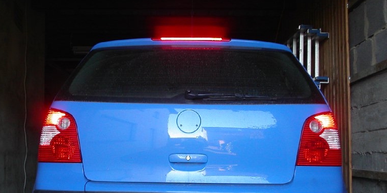

Post24-12-2007, 10:51    Subject: Quote
teileklaus wrote:
There are also power LEDs that are red and have better focus and are brighter, but they consume more power.
My LEDs have a beam angle of 26° – I find that acceptable for a brake light. In addition, the diffuser widens the beam even further.
Power LEDs (such as Superflux multi-chip LEDs) are usually square components with a side length of approximately 7 mm, and I likely wouldn't have been able to properly fit or secure them along with the circuit board inside the flat enclosure.
Here's another direct photo from the back. Although digital cameras struggle to reproduce strong brightness contrasts, you can see from the "halo effects" around the lights that the LEDs aren't actually much dimmer than the 21W bulbs.
The deeper red color at the top still comes from the initial LEDs with a wavelength of 660 nm. In the meantime, I've replaced those with slightly brighter 617 nm LEDs, which produce a very similar tone to the diffuser panels behind the incandescent lamps.
