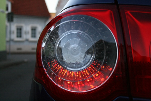

The Passat only flickers when you don't brake.
The flickering can be made visible by using a digital camera with a short enough exposure time. With exposure times of 1/250 of a second or shorter, only parts of the lamp will appear to be lit.
I'll have to try that next time when I'm braking.

As described in the article:
Staring intently helps.
The flickering is usually only noticed when you happen to look at it.
Or your aftermarket lights have a frequency of 25 Hz icon_wink.gif.

Post23-01-2009, 12:48    Subject: Flashing LED Taillights? Causes & Fix. Quote
What settings do I need to adjust on my digital camera?
a short exposure time.
Compact cameras usually can't do that. So, a digital single-lens reflex camera, with pre-set exposure time and shutter release.
With 10% PWM, there's a good chance you won't see anything, as it usually results in all LEDs being off.
When PWM is close to 100%, it becomes statistically more challenging, so simply reduce the duration.
