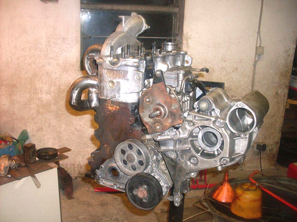

I can offer you a photo...
This is from the Rohan adapter for the charger mount, from two weeks ago.

Just a side note: What have you done to ensure that your AFN (presumably an engine type) can withstand more than 5000 km of head gasket replacement with the attached turbocharger?
Translated on 04-07-2026, 8:37.

@Rainer: Are you concerned about the weight of the charger (support) and the potential tilting loads on the front screws, or about the peak pressures that could stretch the screws?
Screws from PD? Stud bolt?
Translated on 04-07-2026, 8:38.

Head bolts and compression are reduced due to worn pistons.
