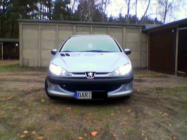

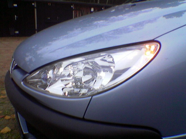

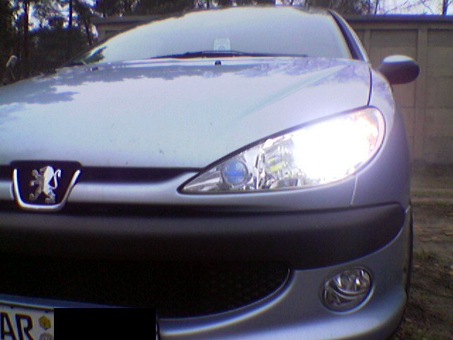

Post22-08-2009, 16:58    Subject: Quote
Last week, I had this xenon kit that has been sitting unused in my garage again. So, I just took some pictures, which I definitely want to share with you!
Abgesehen von der Nichtzulaessigkeit der Xenon-Nachruestsysteme (seine Zulassung hat der Scheinwerfer mit Halogenlampen bekommen!) kommt natuerlich 'ne ganze Menge mehr Licht raus. Wer das (legal) haben will, der sollte das naechste Auto mit serienmaessigem Xenon kaufen. icon_wink.gif
Here are the pictures! Picture 1 shows the low beam headlight with eight-month-old Osram Cool Blue bulbs (also known as "Tesla," from Lidl), and picture 2 shows the Chinese xenon kit. They were installed for testing purposes in reflector headlights of a Peugeot 206.
Note: Distracting street lamp has been digitally removed. Taken with a camera from an SE W810i phone. Not exactly known for its low-light performance, but I think you can still see the difference.
